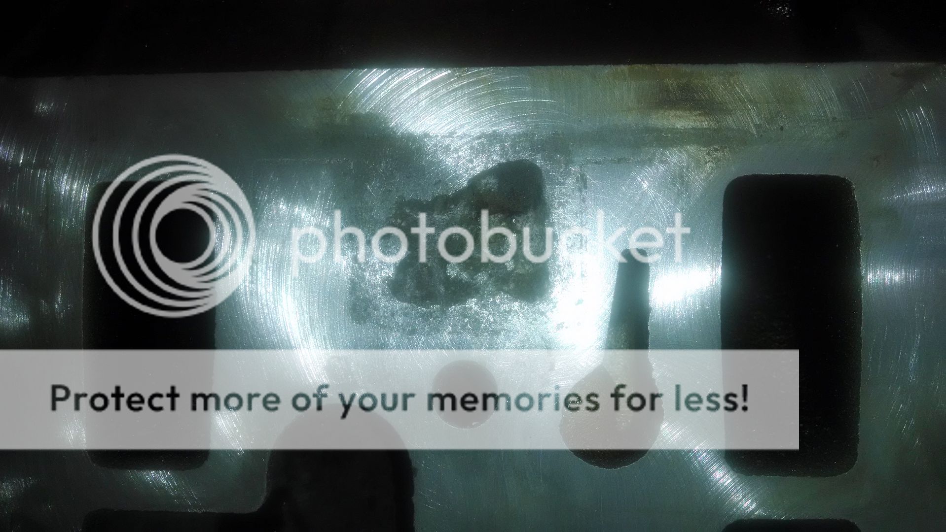

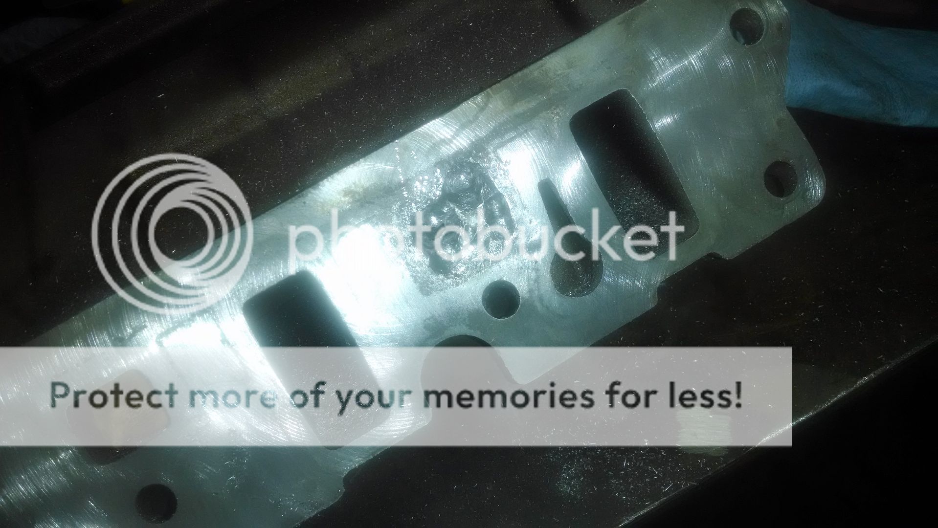

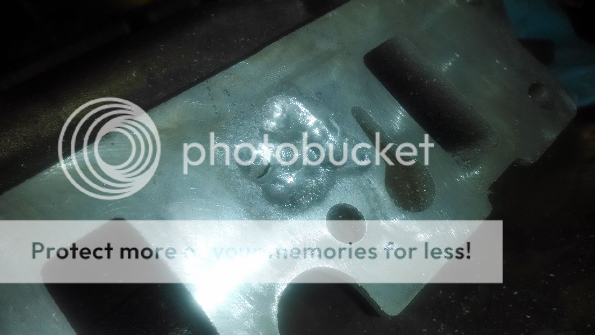

went to the parts store to get all the parts i would need (supercharger gasket and intake gasket. took it all apart and when it came time to clean up the intake i noticed something not right.
i took other pictures but this is the only one that automatically uploaded to photobucket. it doesnt do it justice but the way the heads are set up is there are 4 water passages but on the intake theres only 2. this is one of the passages that are blocked off there was so much crud in the water jacket i guess air was trapped in that passage idk. but the aluminum intake had been eaten away by the dexcool and by time i cleaned all the corrosion out there was a hole in the top side of the intake and it had to be TIGed back and ground down flush.
on each of the old intake gasket each water jackets were broken i couldnt tell you where the leak was coming from cause before all this i had coolant on the top of intake and appeared to be coming from the intake

Sorry to hear that Irish. Looks like you got it all fixed up and working again tho. If your car has alot of miles on it and the gaskets have never been done and the coolant has never been flushed then this sorta thing is possible and on any vehicle.
Dexcool is some pretty good stuff, GM has been using it for a long time and still uses it in brand new engines. That's the first time I've ever seen it do something like that but anything is possible with cars lol. I'll ask some of the guys in the shop on monday if they've ever seen something like that before. Maybe there was something else goin on??

Dexcool and aluminum are the devil. Worst thing GM ever did to aluminum and composite engines. Cavitation and electrolysis with Dexcool = aluminum termites. If it's a rigid flange, you can always clean it up with a wire wheel and fill it with JB weld. Let it setup over night and grind it down. Now if it's the cylinder head mating surface forget about it but intake, waterpump etc those areas are fine to repair in this manner.
Check for electrolysis Irish or you may end up doing it again very soon
