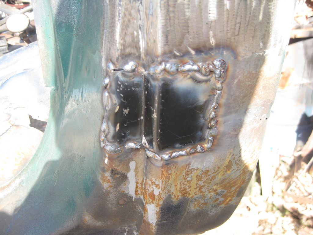

some pics, had to shorten the cab stand to roll it in the garage-initial height was perfect to get it off the saw horses, but I forgot where I had wanted to move it. so used the cherry picker to pick up the cab, worked OK in the dirt
some pics of the floor brace and patches, the patches will be welded tomorrow, got late and cold, need some oil for the garage furnace
and bent up a quick shock brace, got to drill a hole and test fit, but I like it so far, much better then nothing
here is a pic from last week working on the cab corner, used just a patch from the replacement panel, as the only rusted section was from above the previous replacement, I did weld up a couple holes the PO missed welding and just used Filler. I cut it large to make sure I got good metal and the rust hadn't spread
it's not perfect, the PO either used to much heat, or something, the weld line isn't flat but curved in a little. for a daily driver it is acceptable for now, will be trying to use minimal filler so someone may notice if they really look
