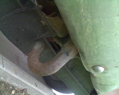

Here are some photos of tow hooks on an '80 K-10 and where the bolt in:

Hey Jason, since we are the subject, I have a set of those 88-up style hooks, did you use existing holes to mount them or drill holes?

There were existing holes in the frame.  If my memory is correct, they lined right up.

They are just like a few sets on eBay for sale right now.  Very rounded on the hook part.  Not squared off on the sides like the ones pictured in beginning of this thread.

There are two styles one for the 73-80 trucks and another for the 81-87 trucks.
81-87 will not fit properly on the 73-80 and vice versa.
The 81-87 are more "S" shape in form than the 73-80 which are more like the GMT400 style.
