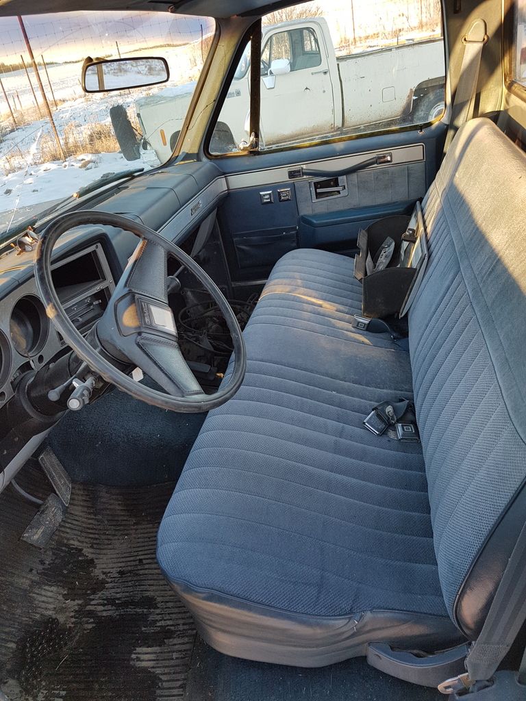

bought this farm wagon this weekend. gonna pull the body off and scrap the body as there isnt a straight piece of sheetmetal on it. 79 k20 with a 350 and a 4 speed, says 96xxx km on the odometer, not sure if its been wrapped over a time or two.
front end
transfer case, its matted to a sm465
rear end. limited slip with a 3.40 ratio
this is my 2wd that i wanna pull the body from and put it on the 4x4 frame.
this will not be a fast build wont even pull the body off till next year when the cement is poured in the shop. but the truck was cheap so i snagged it.
