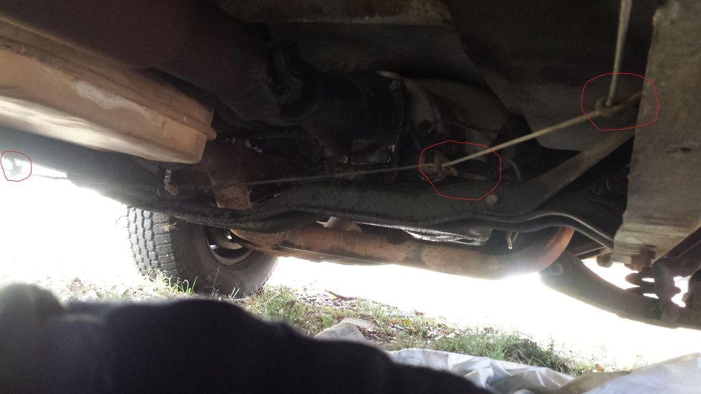

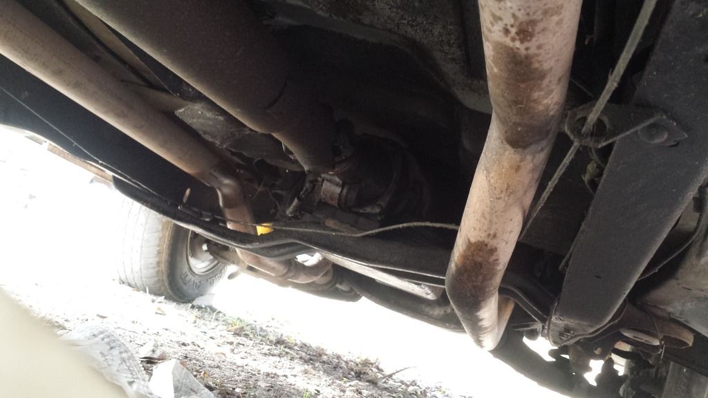

I believe the problem is that I'm missing a few of the cable guides. I'm missing the 3 guides under the cab that look like bent rods. Guides 7,12, and 13 in the illustration.
Here's a pic. Once I saw that cable wrapped around the exhaust like that, I felt like something was off.
Here's a pic from an 82 we have and I circled the 3 guides I'm missing
It seems like somebody took these off because the Dual exhaust got in the way.
I was going to try to get those guides of an 82 4x4 we have but quickly found out they are different from a 2wd.
I feel like if I do get those guides the cable might still be hitting the exhaust because of the Duals, but as long as it works it'll work for me. I'm probably going to end up flipping this truck anyways.
Do yall think I can find those guides online or is my best bet going to the junkyard?
Thank you guys for the help and the pics.

« Reply #4 on: December 21, 2016, 11:54:34 am »
Junk yard or pick up some 1/4" rod stock and fabricate them so that they better fit around the exhaust w/o interference.
