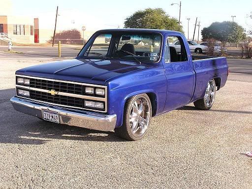

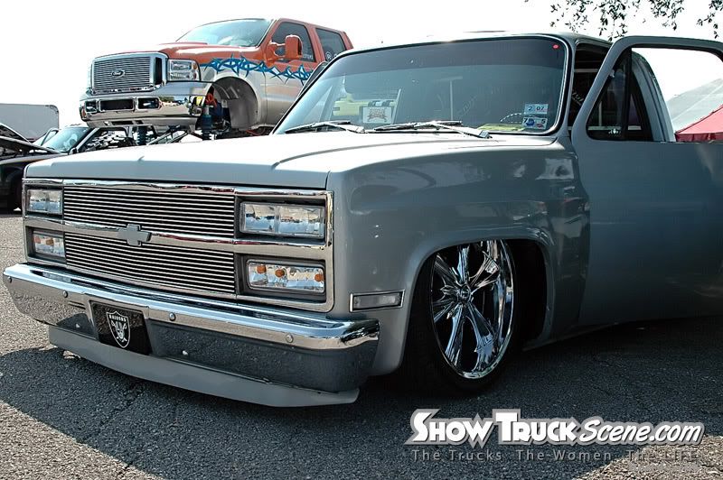

So I finally got all my parts today, the main one infact. So i get home with the core support and try and get my 94-98 headlights to work. I have no idea how this has been done, the brackets on the lights are to big and make the light stick way out and the adjustment bolts dont clear the top of the support. Has anyone seen this done or know where to start? Here are some pics

I think you will find that those are not 94 - 98 lights on those trucks in the pics. 88 - 91 1 tons, Burbs, & Blazers all used that headlight set up as they retained the old body style, but had more modern lights.

To truly give you the right scoop on these front ends, I found all the info I needed by looking at this website.  The picture of the blue truck with the 89-91 quad headlight is what came on the 89-91 suburban and blazer.  There was a single headlight version for the same years.  The core supports are different, but will bolt to any of the 73-87 frames.  I am in the process of converting my 78 to the 89-91 quad grille.  Here is an article with pics showing a swap.
