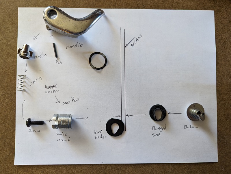

Truck: 81 Silverado. The black washers on the interior side of the vent window handles are breaking apart, and the roll-pin keeps walking out on the driver's side.
Qs:
-What kind of washer do I need to replace it with?
-Can I get it at the local hardware store, or the fasteners section of a NAPA?
-Size?
-Anything I need to know about assembly?
Thank you,
IM

I think I can use a 1" nylon washer, I'll just trace the hole of the original.

The vent goes together like this..  the individual parts are not sold separately.
