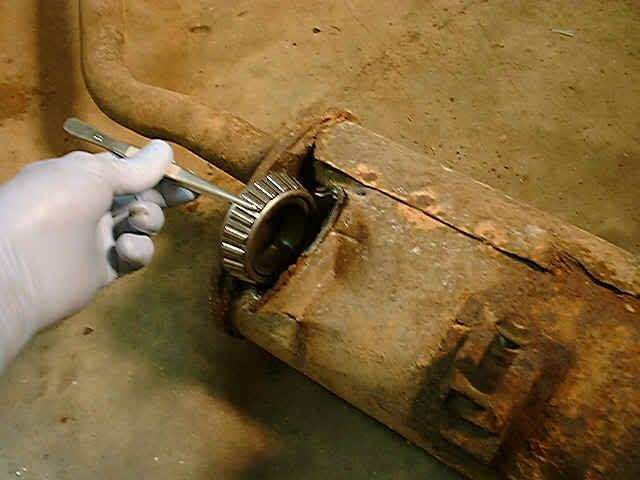

Muffler bearings

Hahahaha good one Ville! Which reminds me, maybe I should go check my muffler bearings.....

Those bearings take a special grease--you have to wear gloves.
Have you checked your windshield washer fluid--if it is too full, it will make that noise.
