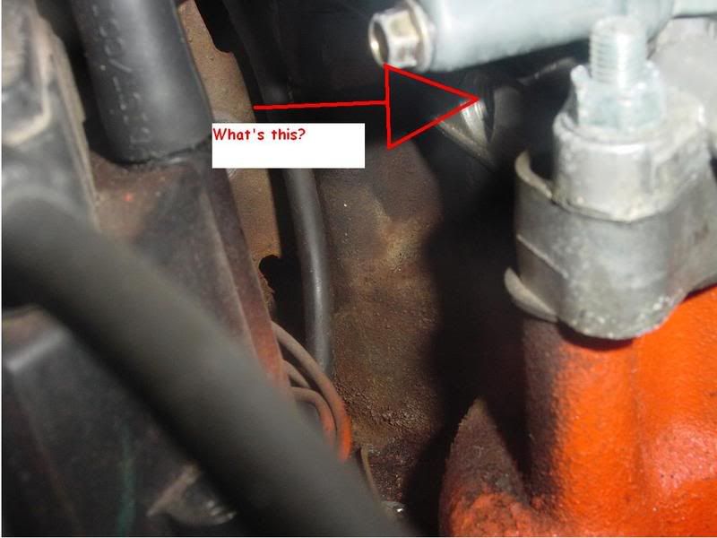

Redneck take some pix of your carb sitting on your engine for us. Both sides, front and back.

« Reply #42 on: March 17, 2008, 05:29:15 pm »
Ok...Side to side front to back..Let me no if u see somthing
Re: Help with engine
« Reply #43 on: March 17, 2008, 05:36:40 pm »
« Reply #44 on: March 17, 2008, 05:38:45 pm »
nevermind, Vile posted that before I got to it...
B)Is there a gasket under that adapter?
