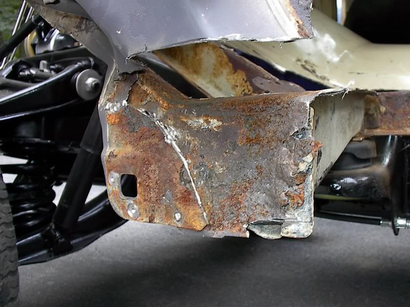

Originally there were no welds there.  The factory installed seam sealer in that joint.  The floor was bent (making part of the inner rocker) down to meet the kick panel at the rocker panel.  Where the hole is in the rocker to bolt the fender up to, there is three layers of metal at the fender hole location.
When I repaired mine, I cut out the floor, dug out the seam sealer at the joint of the floor and the kick panel, cut out all my spot welds, then removed my kick panel and floor.  I then installed the new kick panel, checked the alignment and spot welded it back in.  When I installed the floor, I only spot welded the floor to the kick panel and resealed the joint with seam sealer.  I made sure to get plenty of sealer into the joint.  I sealed the joint from the inside and outside.
This is how bad my kick panel was when I got to this point.
Hope this helps - good luck.
