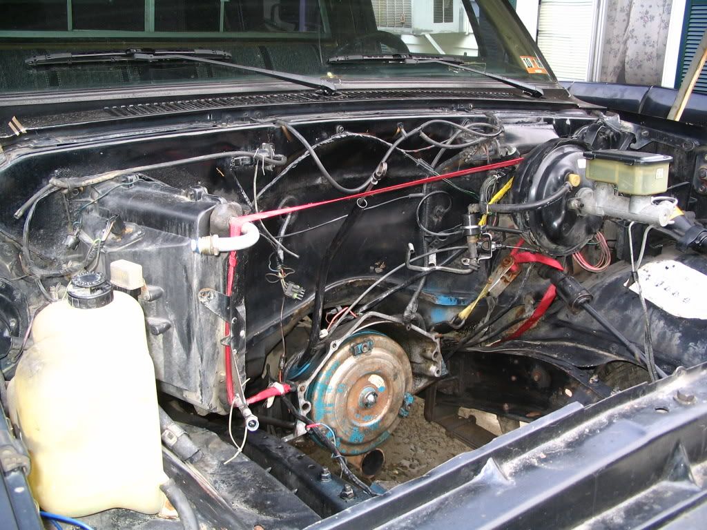

ok here are a few pics from the other truck we had, it had the same hookups and kinda show you more since the motor is gone.
This is not the truck in question though.
This IS the trucl in question...
That was before things got removed. I got new pics just gotta get them on here which I should be able to do tomorrow.
Thanks for the help. Please help me further if you can, anyone.

Is it just me or is the edelbrock in the picture have the vacuum lines hooked to each other? The timed port and full vacuum? Good luck with an '84, I've got one and more dang vacuum lines than I know what to do with!

the driver's side vac. in that pic was running to the dist. and the passenger side was a piece of vac. line about 3 inches long or less with a screw in it.
