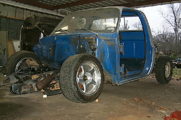

If you want it as low as possible the problem arises in the front, you can only go so low and the control arms will hit the ground.  Spindles and bags set at the correct height will put it on the ground.  This is one of my trucks that I worked on before tearing it down.  The tires are 28" tall and there is just 2.5" spindles with a block set at the installed bag height and no front end on it.  This is your limiting factory.

that truck in those pics looks very close to layin body...how far off is it??...thats amazing haha
