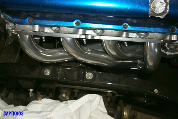

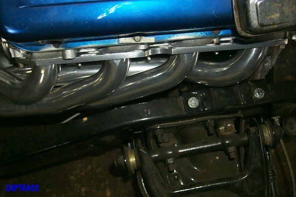

If you route them right, they won't go under the frame.  Mine is going to be 4/6 dropped:

Sweet, that is what Im looking for. Thanks Capt
