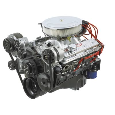

Well, what do yall think of this one?  it's a (330hp / 385ft.lbs.)  350ci  turnkey.  everything, from air cleaner to pan to starter to serpintine setup to ac compressor.  I found it for around $4700 or less at the chevy dealer.
http://store.summitracing.com/partdetail.asp?part=NAL%2D19201328&autoview=sku
I figure with this setup, The final total would be around $5,300 complete.  That's for taxes and all the little things a new engine requires, mounts, hoses, oil, cleaners, etc.
« Last Edit: February 19, 2009, 02:46:30 am by 78 Chevyrado »
