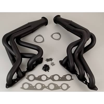

Near as I can tell a local guy as a set of these for sale,
http://tinyurl.com/dmz32r
Seems like they would work, I have to have my exhaust pipes modified to fit whatever header ends up on the engine anyways so as long as there's a little wiggle room to bolt up the exhaust pipe to the header seems like they would work.

What about Sanderson Block Huggers?
Re: BBC Camaro Headers work for a 1975 4x4 Jimmy/Blazer/Truck?
« Reply #2 on: April 15, 2009, 08:54:24 pm »
Sanderson Chevelles work.  I have some on mine.  I posted pics here somewhere.

Sanderson makes a set of BBC headers specifically for 73-87's.
http://www.sandersonheaders.com/product_info.php?cPath=21_23_36&products_id=175
You don't know if you want shorties or longtubes?  I would use shorties only if ground clearance were going to be a problem.  Other than that, I think long tube have a clear performance advantage if you select an appropriate primary diameter/lenth and collector length.

Actually, those are the Chevelle headers, they just fit 73-87's really well.

If you want a pavement pounder don't skimp on the exhaust, especially if the engine will have a long duration cam, which have a tendency to exacerbate power loses due to exhaust backpressure.  Keep searching for a set of quality long tubes.  I don't think $300 is bad for a set of super comps.
