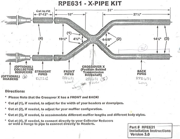

Re: exhaust from jc whitney catalog
« Reply #8 on: April 20, 2009, 03:13:20 pm »
This is the installation instructions.  LWB is longer than a SWB by 14" so you have to remove some off the back to make it fit, it should clamp back together, but I weld all my exhaust.

thanks capt-
this is a project that i would have to bring to my mechanic as it is beyond what i can do alone in my driveway, that being said specifically what modifications will need to be done for this to fit on a short wheel base 2WD fleet. i see four (4) cut scenarios and would like to know in advance which ones i am likely to encounter.
specifics
87 short fleet 2WD with stock 305 and exhaust
i will consider adding headers but have not chosen them yet.
what is the reason for the collector/reducer, only for non header use?
in either case i am assuming some welding is needed here correct?
to make things easier i would also order the quietest muffler option with the exhaust, is this already pieced together or is assembly required by me
it is important that i know what kind of cut and weld fabrication i will be likely to encounter in advance being that my mechanic will be charging for any fabricating services. i like the exhaust but i really need to keep this as simple and cost effective as possible. have any other members installed this on a 2wd short fleet?
thanks
« Reply #10 on: April 21, 2009, 01:50:45 pm »
The kit was designed to be clamped together so the only welding required would be if you chose to add headers.  If it was a Long wheel base, it would clamp together completely.  You will have to use your own down tubes or have some made.  The cutting required would be at the back where the rear tubes connect.  If you cut them they will still slip into the muffler.  If you have narrower down tubes you would have to cut them where the tubes go into the X pipe as stated on the instructions.

« Reply #11 on: April 22, 2009, 12:53:08 am »
still learning and trying to familiarize myself with the terminology...
"You will have to use your own down tubes or have some made"
>when you refer to downtubes do you mean the very last exit pipe after the muffler,
if this is not included are they expensive?
"The cutting required would be at the back where the rear tubes connect.  If you cut them they will still slip into the muffler"
>i am guessing that for the short bed the cutting would occur along the section with the penciled in 21" (back pipe)
"If you have narrower down tubes you would have to cut them where the tubes go into the X pipe as stated on the instructions"
>just need further clarification on downtubes ?
is there a side or rear exit option or just one choice?
thanks

"downtubes" refers to the the pipe at the manifold. This is a system for long tube headers, if your using shorties or stock manifolds then you'll need to fab the gap from this system to the exit.

« Reply #13 on: April 22, 2009, 11:15:51 am »
thanks
Downtubes as CCZ145A stated are the tubes that connect to your manifolds and go down at the beginning of the exhaust.  I don't know how much they would be locally though
Yes it would be cut at the rear section of the back pipe.
