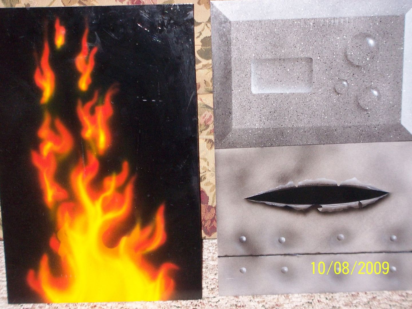

What about painter opinions on Auto Air Colors?  http://www.autoaircolors.com/
What are the painters opinion on Duplicolors Paint Shop?  http://www.duplicolor.com/products/paintshop.html
It know it is lacquer based, they say there is no recoat window on it, but it is limited on the color choices, but...

Chris, Here is a couple tin panels I did with AutoAirColor paint at an airbrush clinic hosted by Mickey Harris. For the last several years he has endorsed their company (been on their payroll ;)) going around the country putting on seminars for them...It's a "must see & do" for anyone, he is a REAL good teacher & entertainer.
 For airbrush work it is real nice (dries fast & doesn't tape track).
 I had my painter clearcoat the panels the next day while he was doing a car. The clear "died back" (slightly dull & grainy) quite a bit, unlike our normal basecoat even though they said it could be top coated with any urethane clear. Because of this I honestly wouldn't use it as a regular basecoat for an entire vehicle, allthough waterbase is "the next big thing" in refinishing & soon everybody will be spraying with water. Like anything else, it will be a learning curve (insert BIG in there somewhere ;D)

I ask about Auto Air out of curiosity.  Hills Hot Rod have been painting a lot of their 73-87's with it.  I don't think it would be good in a outside enviroment, but I was thinking it was more environmentally friendly.
