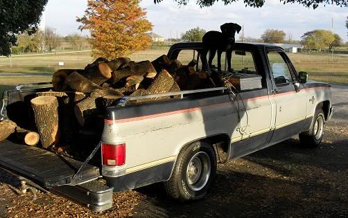

I was looking to get these for my C10:
http://www.summitracing.com/parts/HEL-991/
It obviously needs them, lol.
I always liked riding in my old 77 1/2 ton when it was loaded like that...  only then did it ride like a cadillac. ;D
