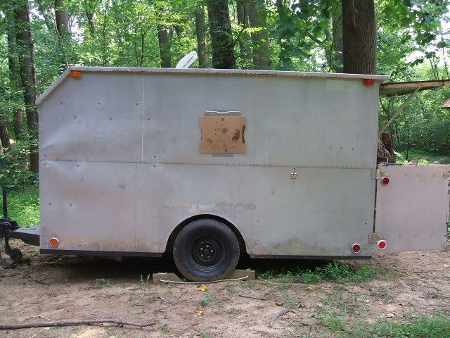

this is how she sat before the flip
We have a trailer store around the corner he was just closed when this happened. Will send the wife to get the new springs.
Dont believe the trailer was overloaded kids didnt pack half the gear we normal put in it.
Wheels are either 14 or 15's after its fixed I might be able to get 16's on there lol

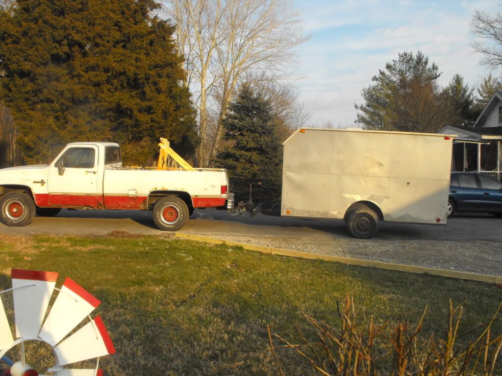

My   camera is acting screwy here it is with the new leafs took it camping this weekend and no issues.
Re: Trailer Axle and Springs
« Reply #12 on: January 19, 2010, 01:26:44 am »
looks a lot better
