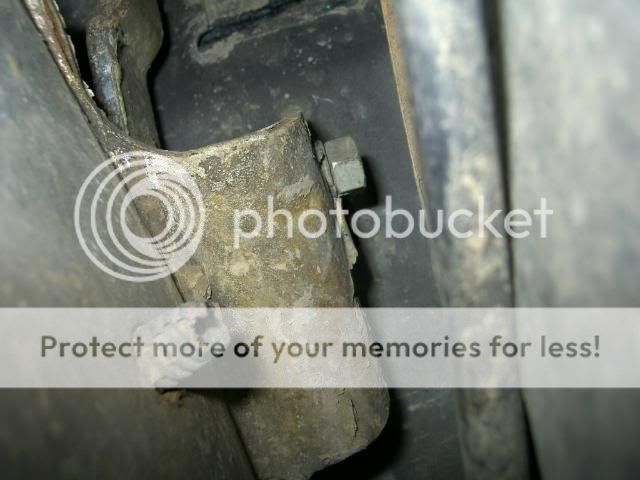

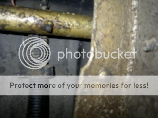

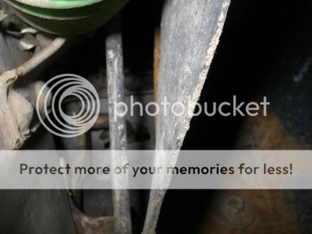

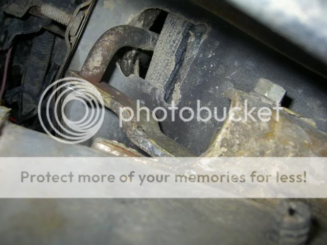

If anyone has these im in desperate need for them, im swapping my 700r4 and np208 to sm465 np208 in a 1984 chevy k10 and i have all the parts im am just unsure where to mount the z bar to frame mount. My bellhousing has the stud i threaded into it instead of the block. If anyone knows please try to explain it to me or post some pics. . . :-\

Haven't got any pics. The frame should have the holes for the bracket that holds the bar.

Nathan, I have the same setup. As Blazin said above, "The holes are on the frame rail" about 8" to the right towards the cab, beside the shock. here are some pics.

I think that should have read 8" to the right of the shock, towards the cab

Picture from the top:
