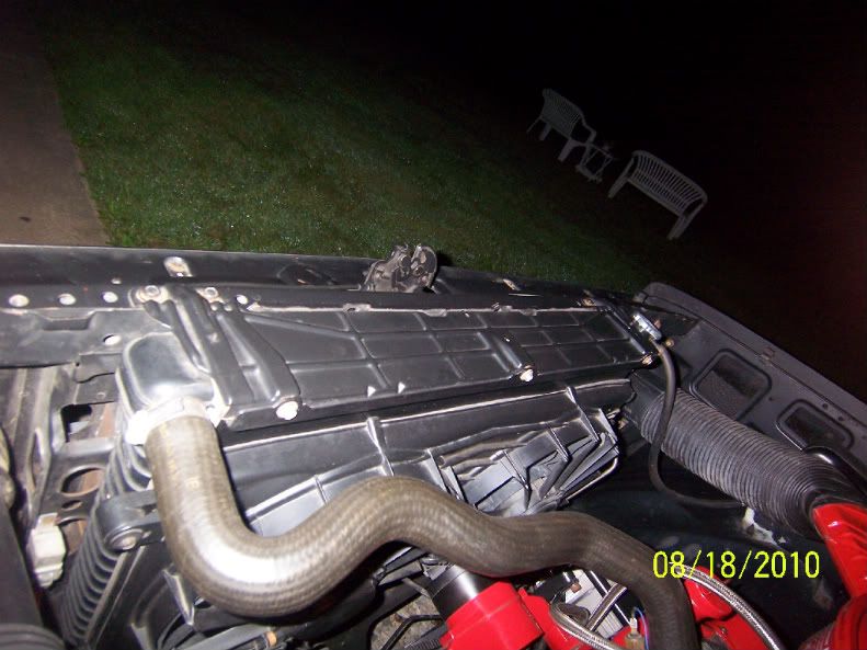

 Here is a picture of the correct 454 stuff for a mid '80's truck

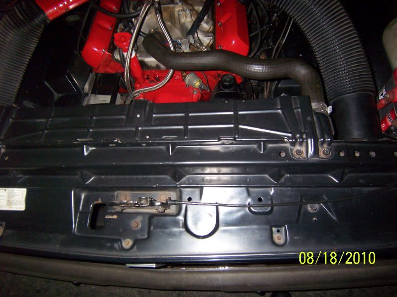

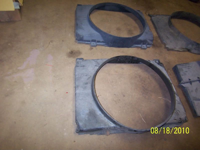

Sux, Here are a couple pic's...Hope this helps.
 The "extra" hose nipple is best plugged with a pipe plug (3/8" or 1/2" threads right in, I did put a rubber cap on also, however they seem to be real cheap anymore & you can allmost watch them dry rot.

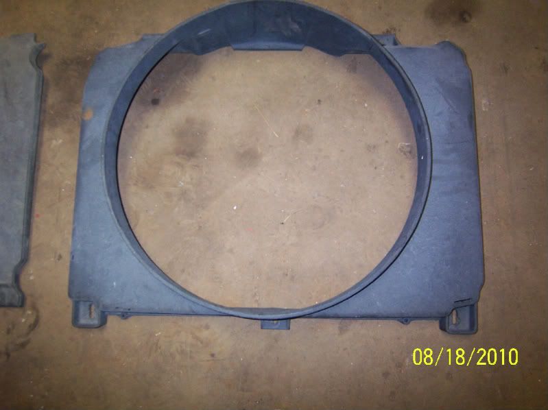

This is the '80's 454 shroud
The only real differences between the '70's shroud & the '80's shroud is the center bolt on the top & the newer one bolts in on the bottom & the older one uses the metal clips.

Those 3 top bolts that are visible at the backside of the rad that go in the top plate, what are those holding? I didn't have those bolts and am using the top plate as the 'clamp' to hold the rad in, with the 4 bolts that go into the top of the core support. It seems to be holding solid.
The 3 bolts on the top now hold my plate for the electric fan assy. Originally they are the 3 that hold the top of the shroud in place, I don't see any good reason they wouldn't be there.
I asked the original seller of the BB rad if I could buy the shroud as well but he said the shroud is too short for my fan, since BB engines are longer and it would put my fan outside of the shroud. That made sense so I didn't buy the one he had. Do you think the fan thing makes sense?
The big block shroud would be a bit farther away from the fan, but it wouldn't be all that much. If it was there...I would have grabbed it. I guess that's how I ended up with the different ones in the picture  ;)
