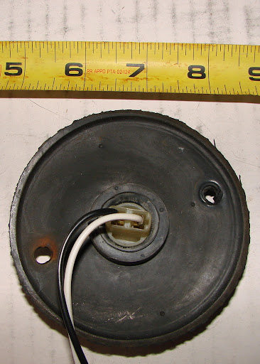

Re: Installing Cab Roof Clearance Lights
« Reply #17 on: November 13, 2011, 03:51:35 pm »
The total outside diameter of the rubber base is nearly 3 1/2 inches
The socket is approximately 3/4 inches
The lens diameter is approximately 3 1/4 inches (across mounting location on bottom)
« Reply #18 on: November 17, 2011, 12:46:35 am »
Thanks Jason, that is very helpful information! That helps a lot. I'll let you guys know when their on. :)
