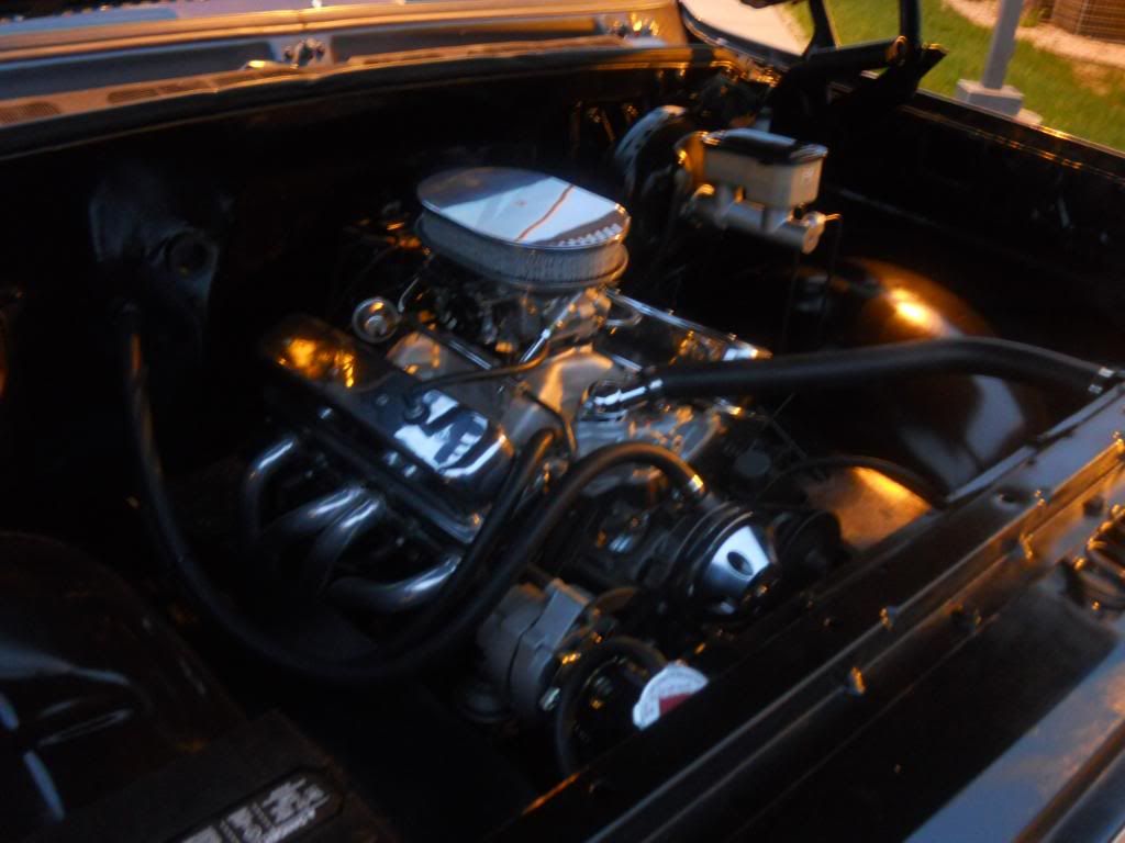

here is the clutch cylinder in place
not my truck but it gives you the idea of the location, notice the fuse pane to the left (its the only place it will fit)

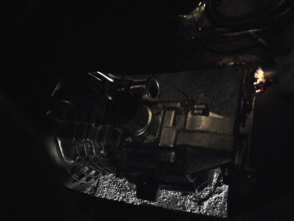

here is how I moved the shifter hole back; in this pic it is cut out, in the second it is swapped end for end, then I welded it in place.
[imghttp://i686.photobucket.com/albums/vv222/titera1/0423111138.jpg]http://[/img]
A pic from the top with the tunnel piece removed
from the bottom
