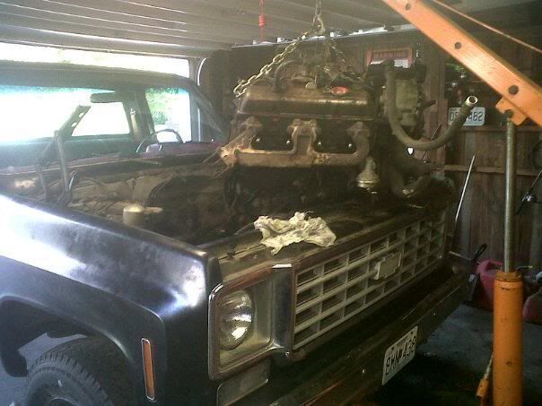

After being unable to isolate what sounded like a rod or torque converter/flexplate knock, I finally decided to pull the pig out. I don't see anything obviously wrong with the flexplate or converter now, but don't see how it's ran this long without locking up to be a spun bearing. I haven't pulled the oil pan yet, may know more after that. It needs to rebuilt anyway, smokes a little, and was made for regular gas. I've done a basic SBC rebuild before but this time I'm considering a couple of options.

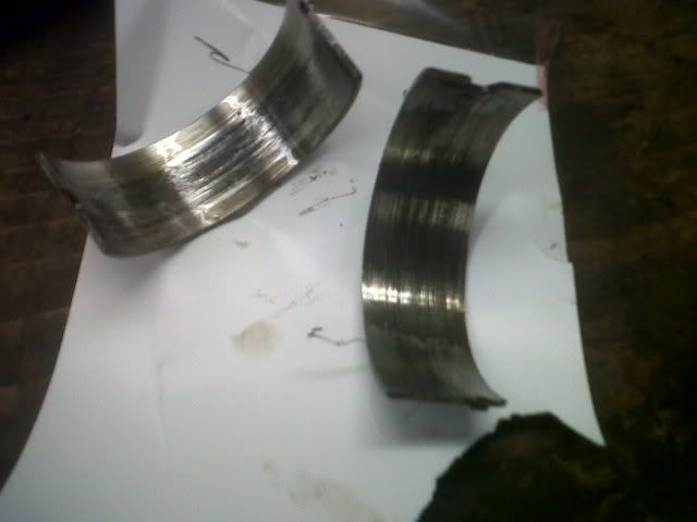

Well, I believe I found the source of the knock:
I was somewhat relived to find this because I was really beginning to wonder if I tore this down for no reason. After pulling the pan and not seeing any shavings I also didn't see anything obviously wrong on the lower end. Until I got to the #5 rod. Unfortunately I think I'm just going to rebuild and ditch the 383 idea, really don't have the coin for it now, and I need to get this beast back on the road. I will have a little extra scratch though and was thinking about an aluminum intake and new carb. A very basic question I should know the answer to, but what kind of improvement should I expect with a dual plane Performer or similar and a 4150 Holley? I know it won't be the torque monster a stroker would, but I'm hoping that combined with a fresh rebuild will wake it up at least a little.
Offline 1980c10
  • Posts: 1205
Re: Going forward...383?
« Reply #6 on: September 30, 2011, 11:16:33 pm »
It will help but now would be the time to add a cam, some flat top pistons and some nicer heads. If its not in your budget to do all of that; do this part now and the carb and intake later. I'm getting close to 400 hp with this combo and well over 400ft lbs of tq. btw for the carb I run a 670 street avenger with bigger jets.
