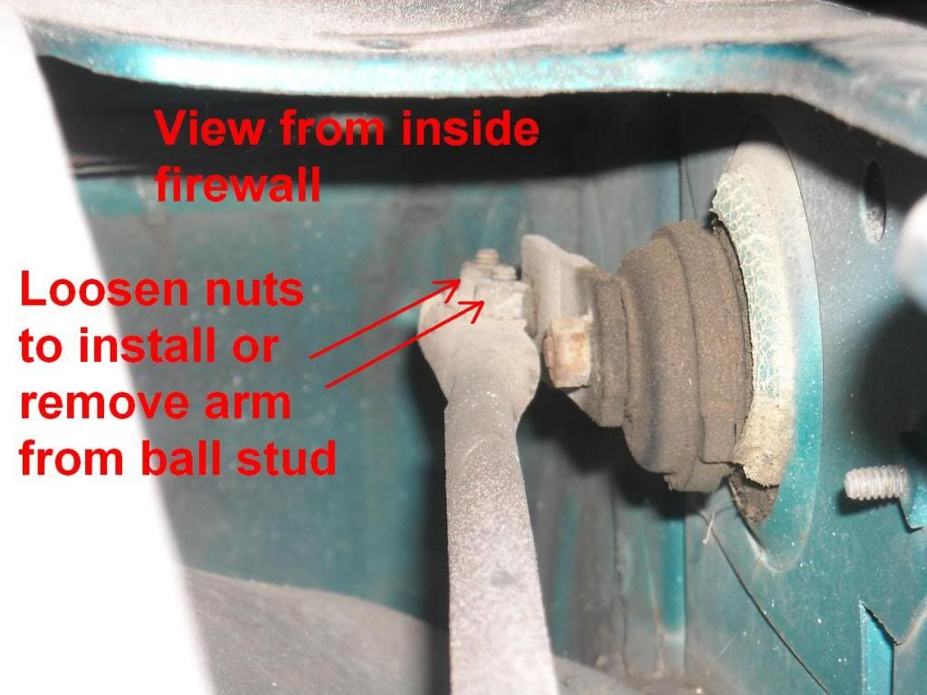

Offline firefighter
  • Posts: 462
Re: Someone help me please!
« Reply #4 on: October 13, 2011, 10:19:36 am »
Here is a pic from inside the cowl area. It's showing the wiper motor arm connected to the wiper linkage.
When you removed the old motor, the ball just popped out of the linkage? I don't think it should have. You should have had to loosen the two nuts to get the ball out of the linkage. Maybe the ball is just a bit larger on the new wiper motor. Anyway, just loosen the two nuts as shown in my picture. There should be an access hole above the wiper motor to get to the nuts from the top. Pop the linkage onto the ball and retighten the nuts. I would even put a dab of grease on the ball first so you don't end up with a squeak from this pivot down the road.
Hope this helps.
Offline mrboyy17
  • Posts: 131
« Reply #5 on: October 13, 2011, 06:24:53 pm »
thank you for the replies.  my wiper arm has no screws or nuts.  its just a rod with the little cup in it facing the ball stud.  its an 86 so maybe firefighters is an older system.  Anyways after 2 hours my neighbor had a gnarly looking crowbar tool that we reamed in the access hole and got the ball to pop back into its home.  i had to get the tool about 2 inches down the rod from the ball stud for it to finally work.  what a pain......isnt it weird how everytime you think a job on our trucks is only gonna take about an hour....well you all know what happens right?!   thanks for the replies though

Offline firefighter
  • Posts: 462
« Reply #6 on: October 13, 2011, 11:36:47 pm »
Glad you got it back on. I feel your pain when things you think will go smooth, DON'T !!
Yeah, my pic is for years 76 and 78 I know for sure.
