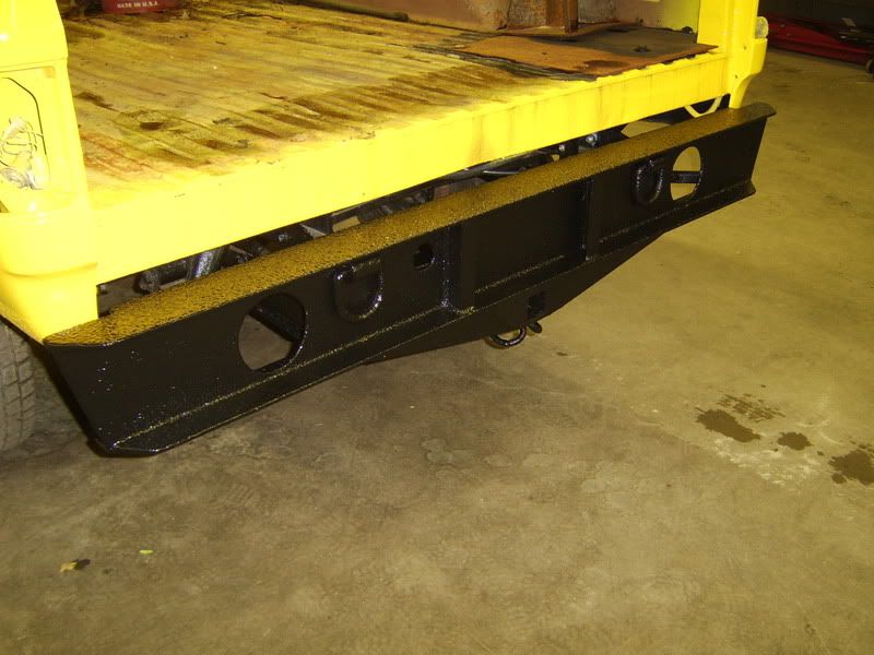

Your best bet is to sand blast it for clean metal adhesion. If not sand blasted then needle scale the heavy rust areas. Any bare metal spray it down with water, let it sit outdoors for a week or so. Get the orange color of rust all over it. If you want to speed up the rusting spray it down with Dupont's 244S etching liquid. Then spray water on it a few hours later. As far as old paint, sand or scuff it down with 180 or 220 paper, then paint around it with Chassis Saver. Then top coat the whole thing with and acrylic enamel. It is best to top coat within an hour to 6 or 8 hours of applying the Chassis Saver. Have used Chassis Saver, and POR15 this way many times.
Most of the roof on my 55 is brush painted with Chassis Saver, After I sanded all the surface rust with 80 grit, then 180 grit paper on a DA. Then primed with several coats of high build urethane primer.  Sanded, and top coated with acrylic enamel.
I sand blasted the rims on my truck, left them out doors for about a month. Brought them in, took a brand new hand held wire brush to them. Blew them off with air, then brushed them with Chassis Saver, then sprayed acrylic enamel over it about an hour later. They have held up spectacular for 3 plus years now.
Did the same with my front bumper, except I top coated it with SEM spray on bed liner. Rear bumper was a piece of I beam that had been laying out doors for about 8 years. Needle scaled it, Chassis Saver, and top coat with SEM bed liner. It has a couple small chips on the very edge after 3 plus years of backing into snow banks, winter sand piles, climbing in and out, dragging chains across it. And the inside edge of the D rings are scraped off from chains.
Chassis Saver:
SEM:
Right after spraying them. I forgot to take pics of them before!:
Same wheels almost three years later. At that point they had winter and summer tires swapped on and off twice. Plus run in the winter, plowing etc.:
Bumper last winter:
