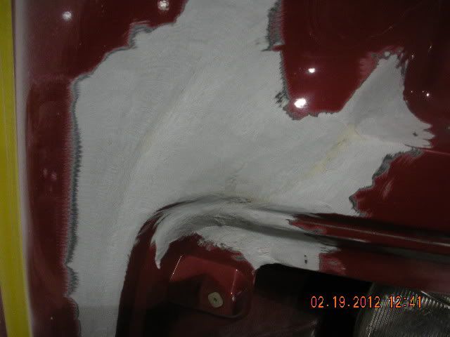

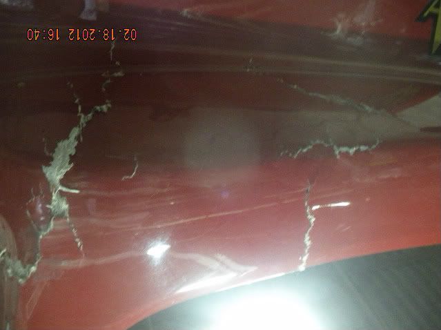

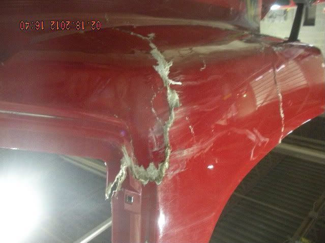

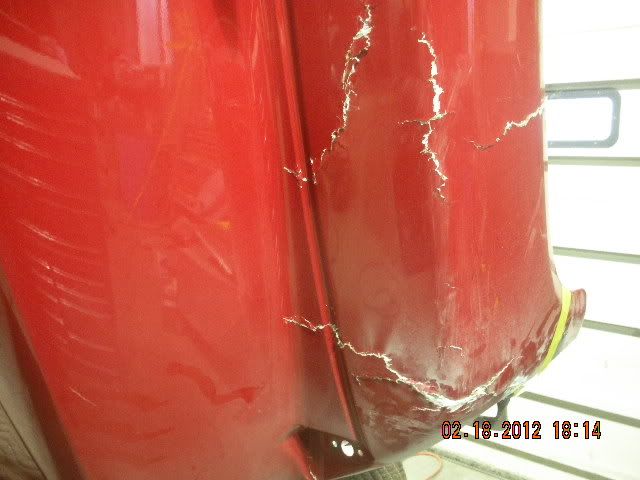

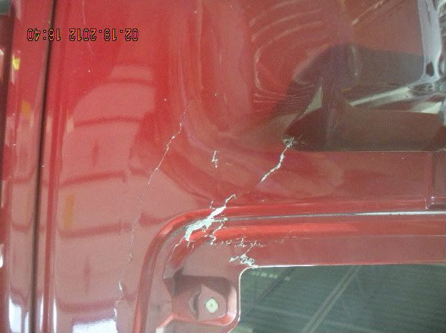

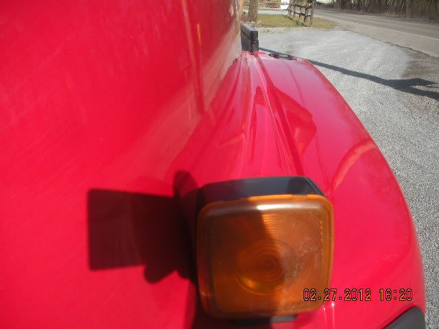

The Front:

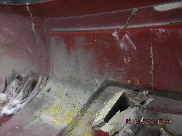

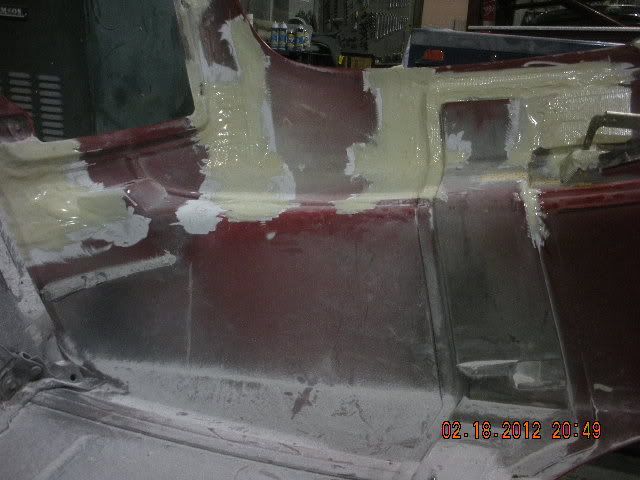

The underside (structure) of the front was damaged quite a bit also:

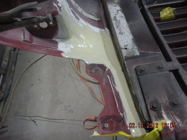

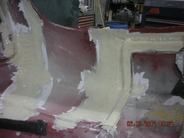

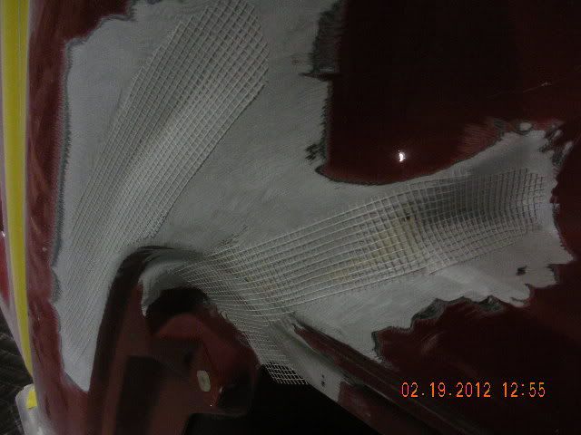

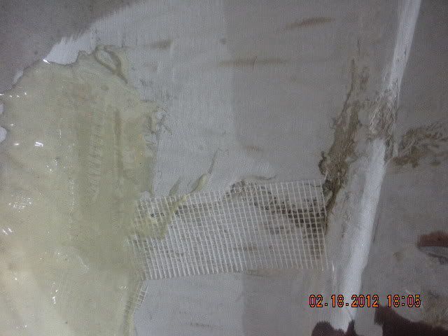

After cleaning & sanding with 36 grit, the parts were fitted back together...clamped & braced. Then plastic drywall mesh & the Fusor adhesive was applied to the backside:
After Two layers of mesh & goo, the backside was done:

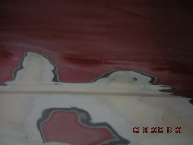

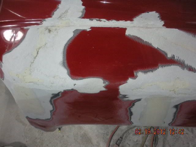

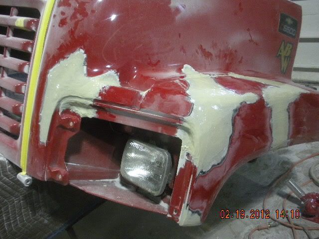

Then I glued the headlamp bucket in & let that set up before turning the front over. The topside was then "V ed" down until the glue was hit remove the loose broken plastic & prepare for the application on the topside:
Two more layer were added to the topside:

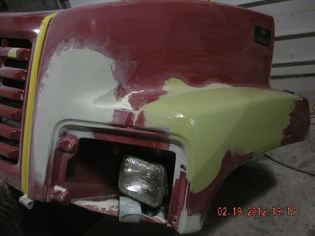

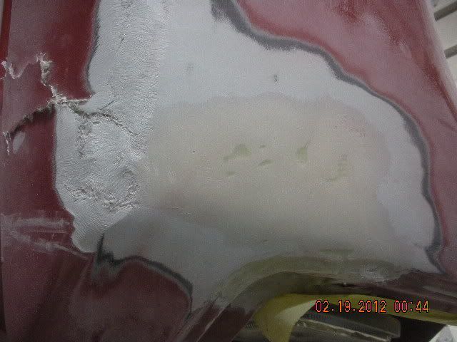

And sanded smooth:

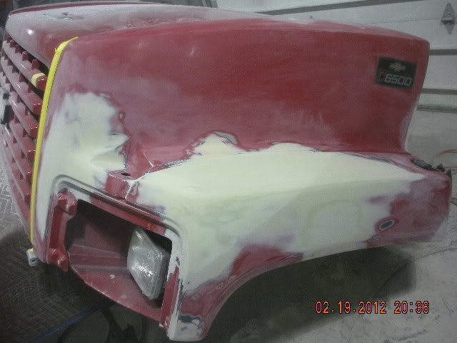

A layer or Two of bodyfiller & glaze:

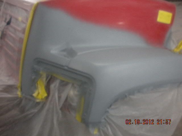

It's off to the booth for a couple coats urethane primer:

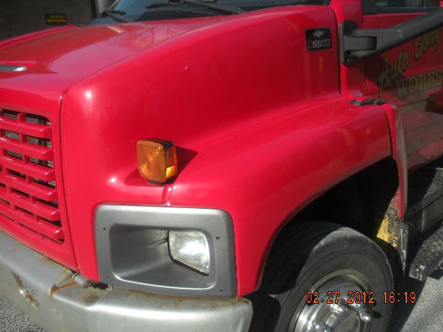

Followed by some basecoat & clear, then back on the truck:
I've used the Fusor 100ez & drywall mesh in many applications like above & it holds up well when properly applied. Hope this helps someone in some way. Lorne
