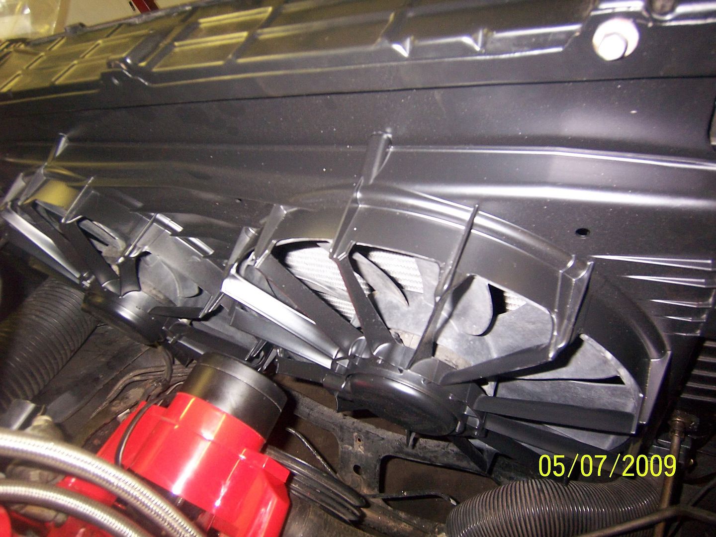

Hey all,
Just wanted anyone who was looking or thinking about putting electric fans on their pickups I have just got mine on and they work.. how great on cruising im not sure yet, testing still to come!
But in the mean time, this is what i used:
Dorman 620-634 Fans, theyre rated at 1100 per fan with 5 amps of pull each fan.
These fans are for 02 and earlier year range camaro's/firebirds with the LS1 5.7, apparently the vettes of that year range as well. So I figure if it can cool an LS1 without as much air intake through the radiator as our trucks, then it can cool a 350 with ease. (still have to make sure lol)
Derale 16739 180 Degree Farenheit Single Stage Electric Fan Controller
This is an extremely easy install for these fans. Had no problems, hooked up the yellow (ign on/off switch source) to the distributor battery feed wire. Temperature attachment was different than in the picture and way easier to work with... hooked it up to the cooling port after the thermostat housing. It was a 2 prong connector, one wire for the relay and one wire to the distributor (ign on/off source) as previously stated. 180 degrees on, 165 degrees off.
Derale 13001 Plastic Rod Mounting Kit
Standard mounting plastic zips, would recommend more than the 4, probably put at least 6 in total at least just to support the fan kit, not that its that heavy but i'm sure it wouldnt hurt.
The actual wiring for the fan, it doesnt come with any. I got my connectors from a junkyard off a 99+ body style camaro with a v6.. you can also order online but junkyard is cheaper of course.

Do you have any other pictures? Maybe from farther back. I'm just looking to see how we'll they fit.

August 19, 2013, 11:05:39 pm »
Ill get some more pictures tomorrow and gonna get my throttle return on and get the exhaust welded up and the testing will begin!

I know it's been some time since i've installed these, but I finally got my truck going after a headache of problems. I drove it to work yesterday!
So, my temp gauge doesn't work for some reason so I can't give exact temperatures on this setup. What i can tell you though is at idle, the fans kick on and move a lot of hot air from the radiator and they will kick off (its 185 on/160 off) So i know they'll work.
Anyways, driving to work they never came on, it was about 75 here yesterday and I caught a couple of lights. So all in all i'd say the motor doesn't get hot enough to set the fan off and i'd never hear it over the exhaust anyways. I'm pretty sure I put a 180 thermostat in it.
I will update this post in the summer when the Texas heat is out and the fans will most likely be worked.
As far as current pull, I didn't really notice any drop in current. Of course I just put a new 140A alternator in so....
