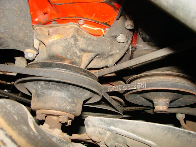

Waterpump, power steering and crankshaft pulley on my '74 Chevrolet K10
Photos from my '74 Chevrolet K10 (350 with centerbolt valvecover heads).  My setup isn't absolutely factory correct, but it works very well.
View of waterpump, powersteering and crankshaft pulley.

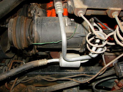

View of compressor mounting

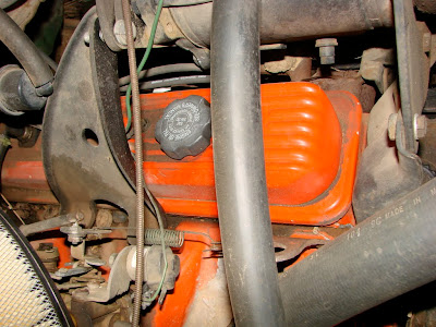

View of compressor mounting brackets at intake manifold
View of lower compressor mounting brackets.  Note: the power steering mounting bracket is modified from a non-A/C bracket.
