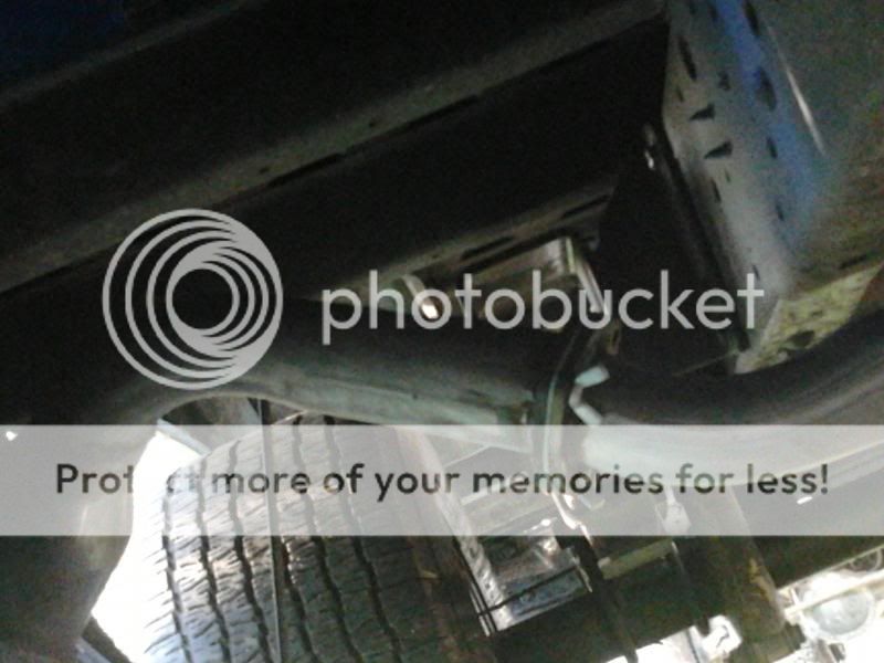

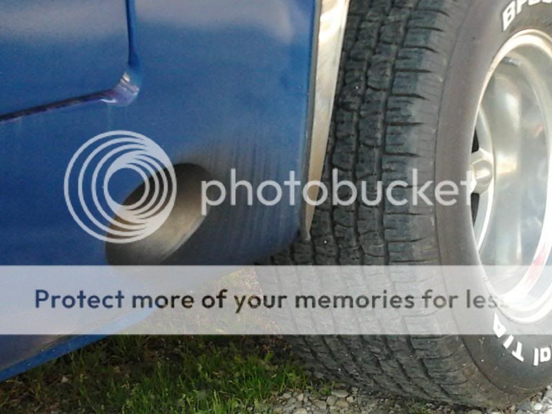

what do you guys think of the exhaust system I built for my 84 swb chevy silverado? I have true dual 2.5" with electric dumps and 4" tips molded through the box sideshere are some pics thanks Marc

Nice work, I had trouble finding the exhaust in the top picture! It blends in very well. You did a great job matching it to the bed. Are you concerned that over time the heat and fumes will discolor the paint in front of the wheel well?

that first pic is right after painting it so the tips had a little bit of overspray in them and no im not concerned at all because i can drive the truck for a solid hour strait and hop out and still be able to touch the exhaust tips and the carbon just washes off with a little bit of scrubbing

You could always put that protective coating around the exhaust exit's, sorry I can not recall it's name. I saw it on u-tube video, it is suppose to be clear and mildly heat resistant.
Other than that I love the set up, very clean and well constructed. Did you do the electric dumps just for the sound or do you race your truck also ?

Looks clean and smooth ~ nice work. making them even is not easy.
I did exhaust work for 10 yrs and the problem we ran into anytime you solid mount the exhaust to the body or frame is the exhaust will move / vibrate / flex at a different rate then the body / frame as you drive. This usually leads to stress fractures / breakage... A flex pipe in the system my help to dampen the harmonic vibes. Also hard mounting the exhaust can give a coffee can rattle sound where the entire truck becomes a speaker exhibiting noise from the exhaust vibration.
If it runs cool enough 3" marine exhaust hose would give the flex and vibration dampening you need to keep the rattle and breakage to a minimum.

IThanks and I do have 2 small flex pipes to try to keep down on vibrations.
