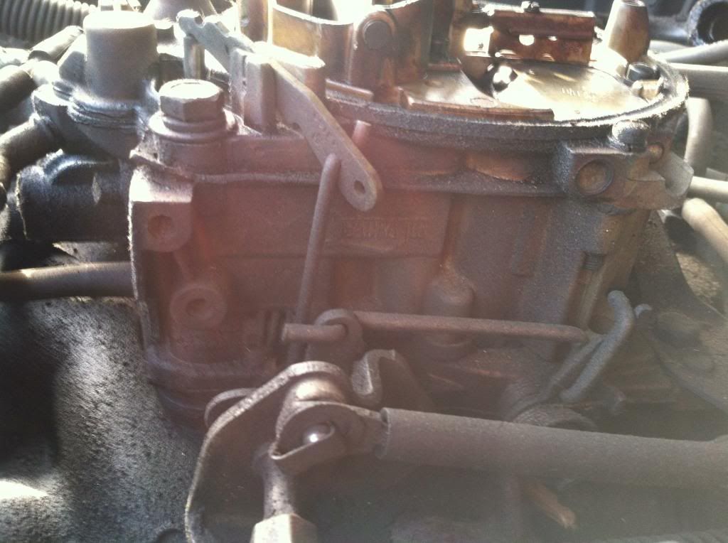

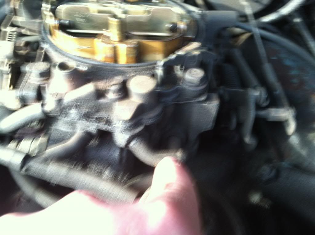

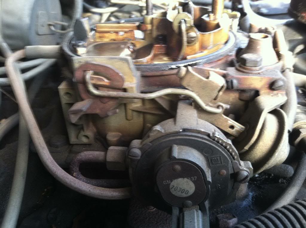

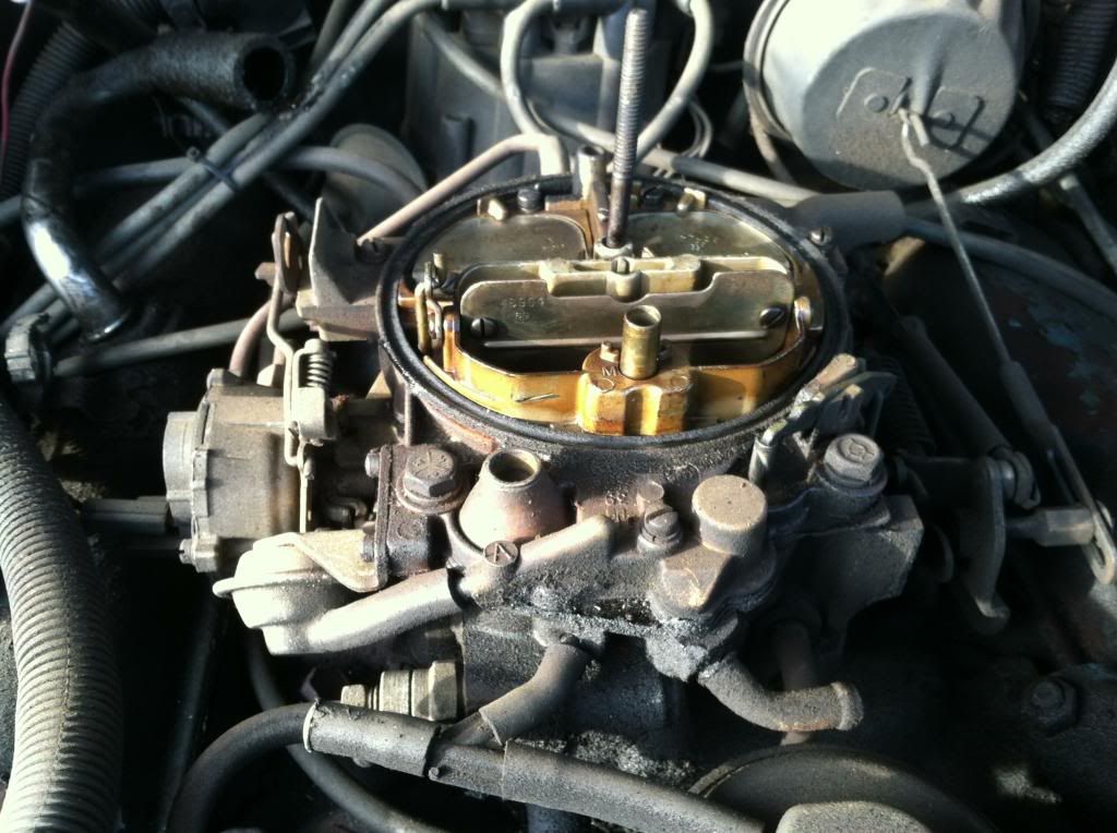

well idk what carb this is but all i know is it smells of unburnt fuel at the rear of my truck heres some pics of the truck and what the carb looks like also in the one pic what is the thing im pointing to cause it looks like something is suppose to be there but theres nothing unplugged on the truck thanks in advance

That is a quadrajet, if you look at your third picture its stamped on the side. Im not sure what the port is on the carb, but if it has vacuum either at idle or revved up a little you need to plug it.
On the side where its stamped Quadrajet just behind it there is a stamped number running vertically. You can buy a rebuild kit by referring to that number.

Quote from: bigchevyc30 on April 06, 2013, 05:55:21 pm
You're pointing to the bowl vent that should plumb to the vapor canister.

April 06, 2013, 09:05:46 pm »
If that is for a vapor canister then it should have been plugged from factory cause my truck never had anything for emissions
