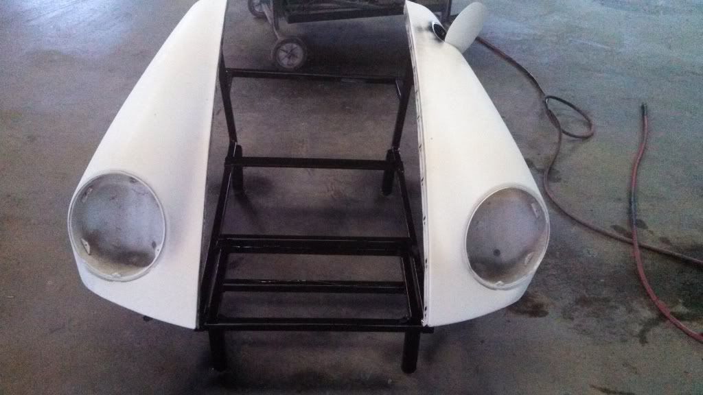

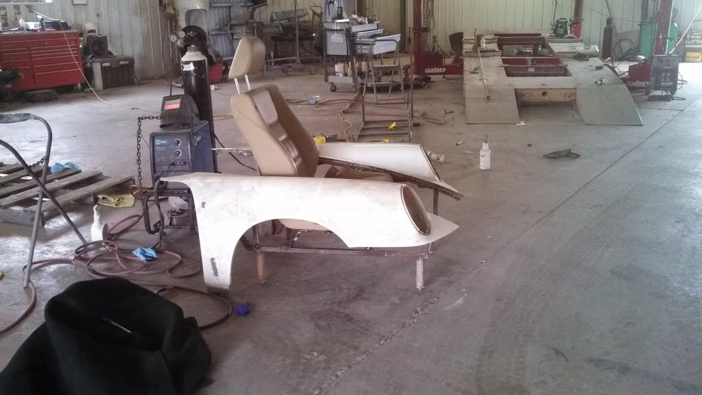

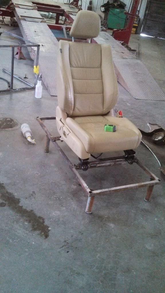

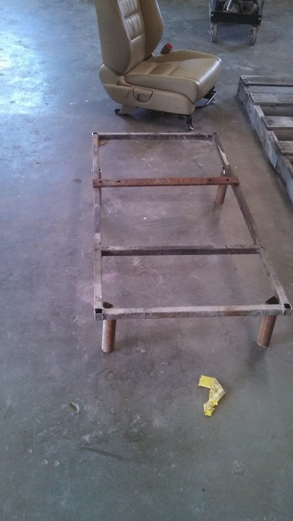

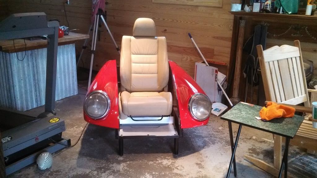

Project I'm doing at work. Guy wants a custom game seat I'll post updates as I go hoping to hav it done this week, already have the seat frame built I'll be mounting fenders to the side today.

Looks like a cool start.  Is this for home computer games?

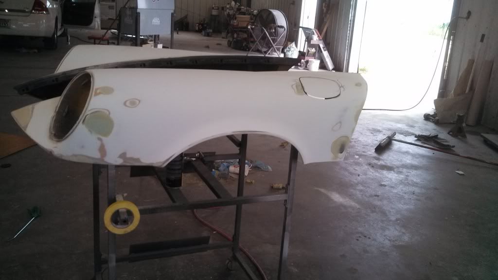

Yeah, he ha a game room in his house. Computer ps3 Xbox all that good stuff. Did all the body work on the fenders today, they were loaded with rust and body filler... after I had them fixed he came in and decided he wanted to get them cut up lol I'll post some more pics tomorrow looks like it'll be getting painted friday

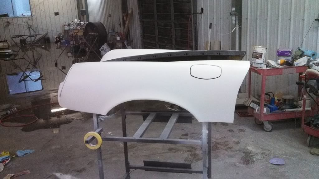

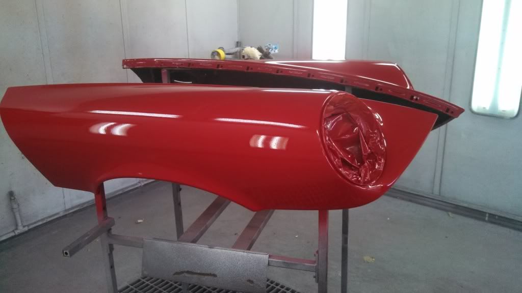

Dents bad prior body work fixed and rust holes fixed.
Primed and ready to be blocked in the morning. ( our shop started flooding in the back... lol had some rough weather in Alabama today)

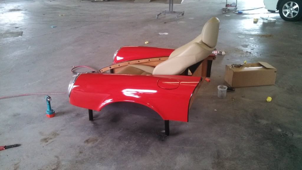

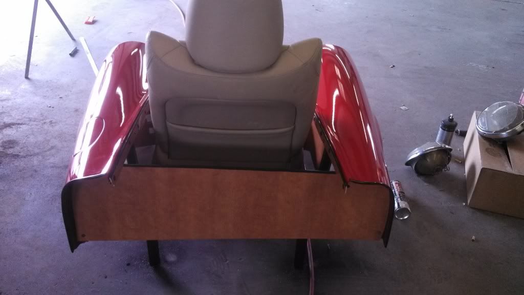

Im getting paid to do it ;) customer wants it for a game room and its pretty comfy chair is fully working, slide, tilt, and I've wired it up for lumbar controls. Also under the gas lit will be controlls and head light switch

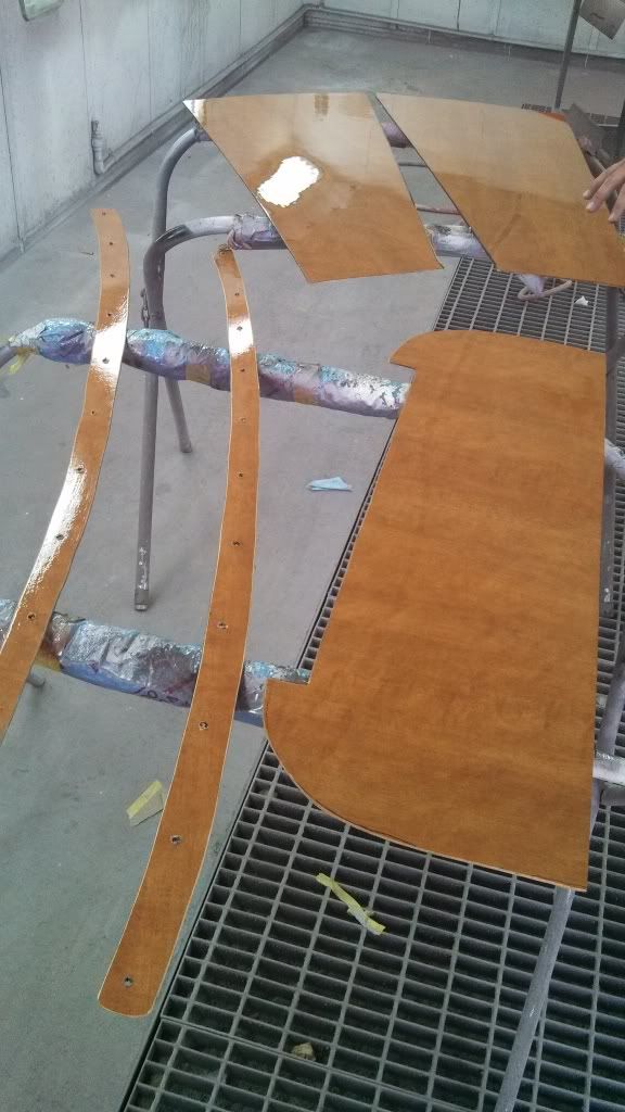

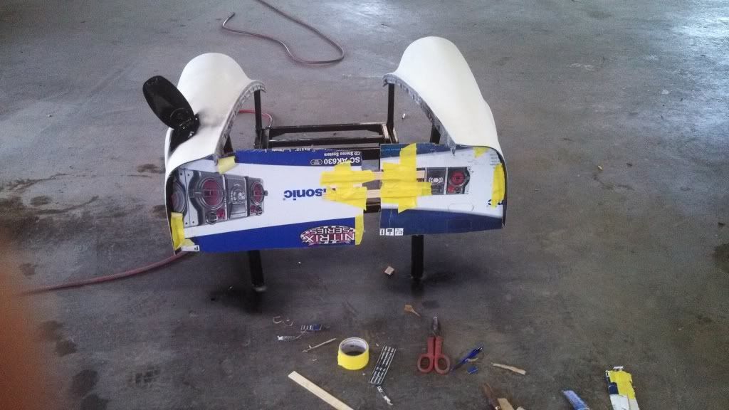

Frame painted
Template for the back panel. Not so pretty lol but the panel will be.

« Reply #9 on: April 15, 2013, 04:27:55 pm »
Panels finished.
Fenders painted. It should be close to being done tomorrow youll at least have an idea of what it'll look like

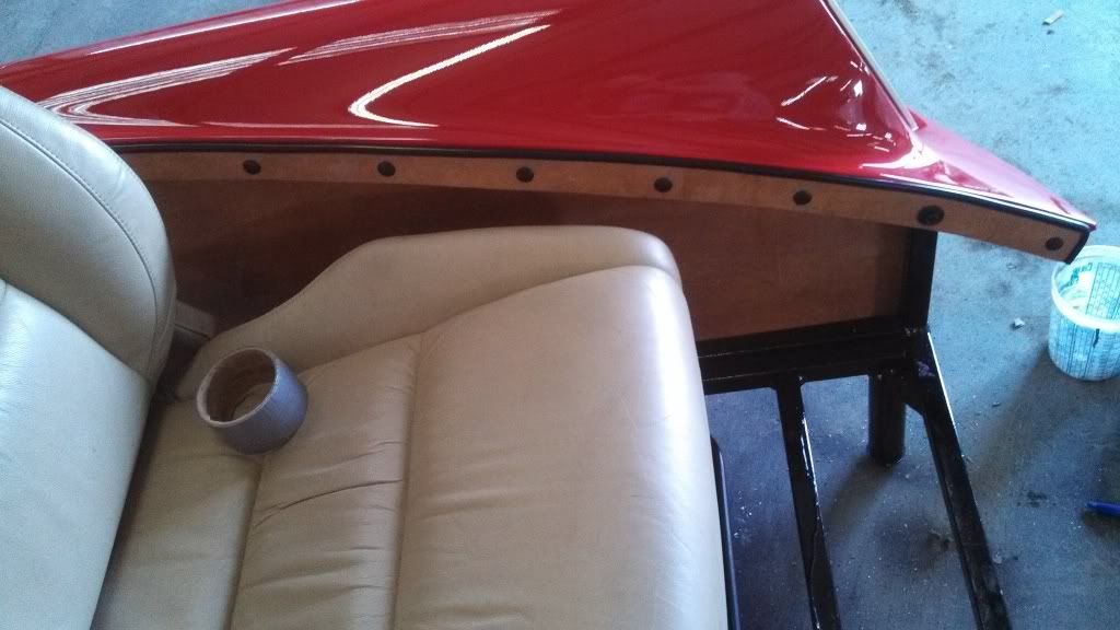

« Reply #10 on: April 16, 2013, 08:23:34 pm »

« Reply #13 on: April 17, 2013, 01:16:49 pm »
That what we were gonna do. I ran a cable to it so you can pop it open from under the seat. The guy wanted the switches for the head lights in there though. Kinda a weird spot to put cups as far as being able to reach them comfortably
