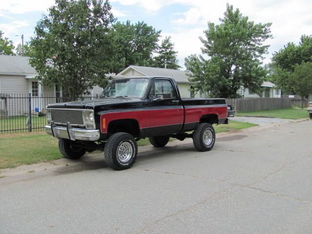

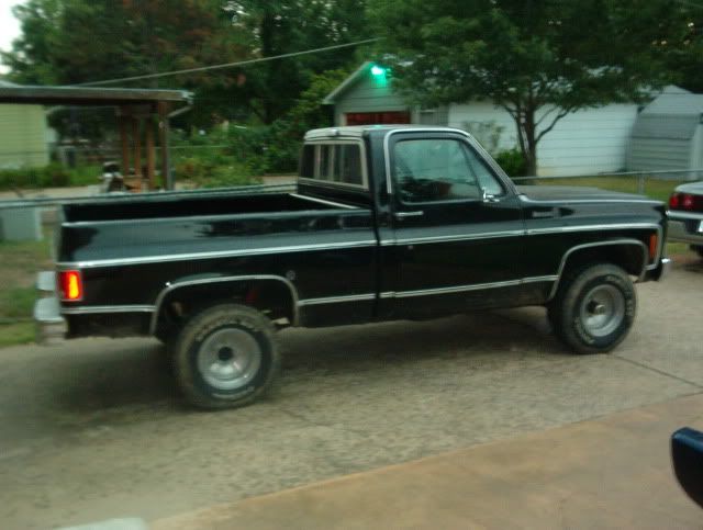

Hey guys, new to the forum and thought I'd show the progress of my truck over the past three years. It's a 79 Bonanza I bought from a friend's dad with ~80,000 original miles. Was a 350/350 with the NP203 T-case, but the 4 wheel drive wasn't working. I drove it for about a year when it started having mechanical problems and lost about half it's clearcoat. It sat for awhile so I could get all the parts/money together to turn it into what it is today. A pic from the day I bought it:
And right before all the work was done:
Swapped in a 355 from my 71 C10 I sold to get this truck, Had the trans rebuilt and ditched the non-working 203 for an NP205. Added a 4" BDS lift and recently had it painted.
Few pics during the swap, and how it looks now:

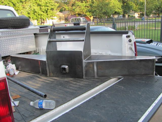

Next up is to powdercoat and install the new bumper
and to get the bed and rocker panels rhino lined. Next year will be working on the front/rearends. Want to go with Dana 60's as this will be my play toy at the dunes and I will be running paddles. Not sure if the 12 bolt and Dana 44 are going to hold up.

Thats a heavy duty bumper!

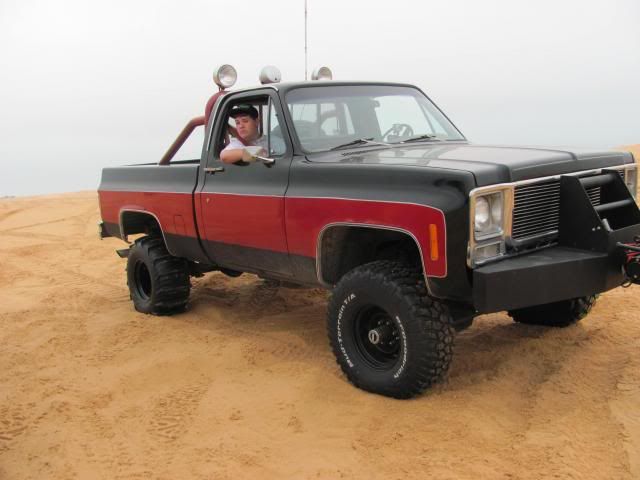

Wow it's been forever but it's finally done. I ended up going with a 700R4 trans which turned out to be more work than I thought it would. With the 205 t-case, the front driveshaft was hitting the trans pan. Even with the double cardian removed and a standard yoke, the driveshaft was hitting on the yoke and getting into a bind. Had to get a new output shaft to make everything work right. 4.10's installed and the stall converter removed alongside the 700R4 and the fuel mileage is much better. Finally got to the dunes and had a blast. She gets around great. Can't wait for winter to hopefully play in the snow.
