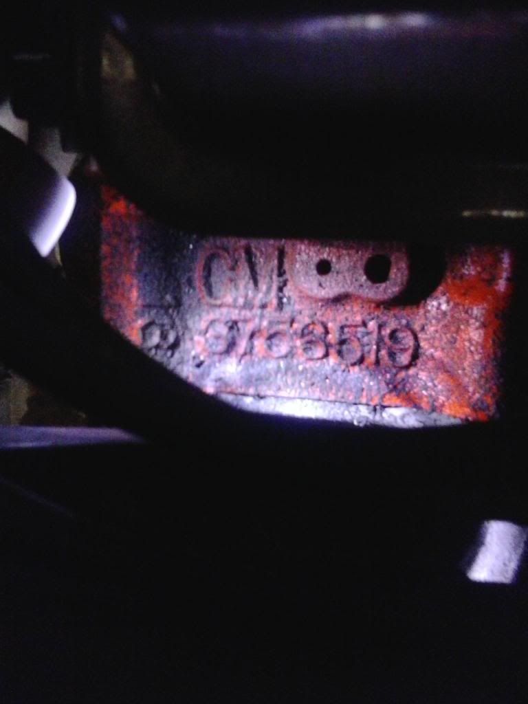

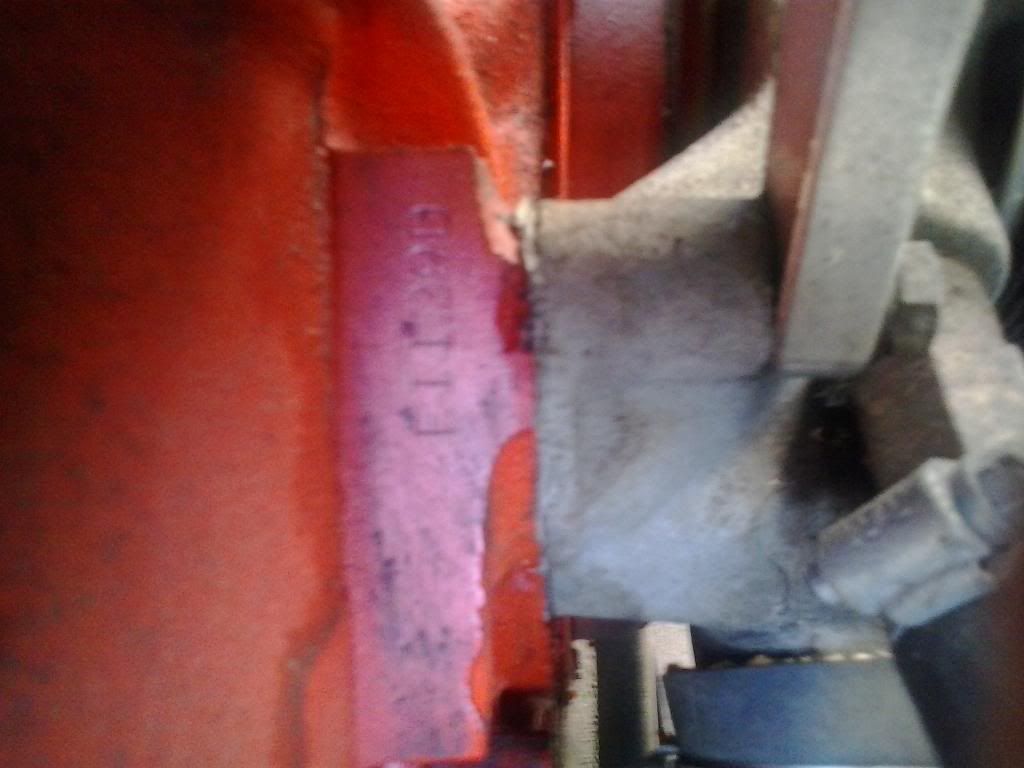

Alright so on my engine in my truck I pulled the casting number and it is 3756519 which I found online is a 58 to 62 year model 283 Engine. Also searched the VIN, which is FII29D. I was unable to find any information on the engine using that VIN number, wondering if anyone had any ideas as far as what that could be...?

1958-62    3756519    283   170hp-   315hp    2 bolt main      car, truck  D indicates a 1958  (185hp) or a 1960(170hp) with a powerglide transmission and 2 bbl carbs.  F indicates the engine was made in Flint
