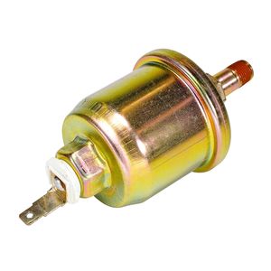

Can anyone tell me what the sensor threaded into the rear of the intake manifold is on my 305 is?  I have an "H" code VIN number.  It almost looks like an Oxygen sensor, but thought that would be down on the exhaust.  I noticed it the other day during my tinkering.  It's on top of the intake, screwed directly into the intake right behind the carburetor.  It has a wire coming out of the top. Any clue??

most ports directly behind the carb are for manifold vacuum.
so maybe a MAP (manifold absolute pressure) sensor?
That's an odd location for a truck engine sensor.  Can you post a pic?

the only sensor i can think of behind the carb is the oil pressure switch and it does have one wire if you have a gauge

Sure, I'll take a pic this afternoon if it's not raining too hard, got this tropical storm Karen coming my way, so it may be raining this afternoon, not sure.  I'll do my best.  The reason why I ask is that when I was doing my tune up recently, the sensor looked like it was threaded in crooked into the manifold, and was gonna fix it.  I thought it might be an O2 sensor.  When I started reading what an 2 sensor does, it sounded like a lot of what I was suffering from.  I looked up the part, not very expensive, so I thought I would just replace it.  I'll try to get a pic up today.

If you have a stock carbureted 305 engine, you don't have an O2 sensor. I think its what Irish Alley posted......oil pressure sending unit.....they do look crooked.
O2 sensor is mounted near the exhaust manifold  (usually just below it) and would send information to a computer.
