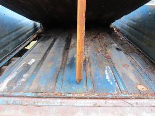

oh, one more thing...  my bed floor boards need replacing, can I use 1x6 from the lumber yard or do I need something special?  these will be more of a temporary thing but the 2 outer boards are the bad ones and the rest seem to be decent and will definitely last for another year I would think.
Re: Finally had a chance...
« Reply #7 on: January 03, 2014, 08:53:45 pm »
     If you are going to be replacing your bed boards anyway, use what you got, or put a piece of plywood in it.
