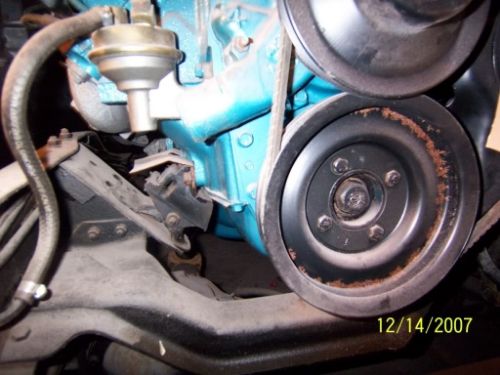

1st off - this is NOT a show truck, so YES there are detail error in the engine bay. I'll work on them over time. '74 k20, sb400/th350/np203
Ok so I could use some help here. Due to delays on the various build aspects, I had to try and make as much progress as I could, with what I had. Basically I installed the motor, while the trans was being worked over. Installed the trans separately. Now hoping to get my t-case this week, and HOPING to fire up this weekend.
So I removed my old motor trans as a unit, then removed the factory trans lines while out of the truck. I installed the motor 1st this time, and installed the trans a week or so later, now I want to install my trans lines in the factory route. I’ve got my old lines and new straight lines ready to bend. BUT HOW do I snake the lines next to my fuel pump, under my motor-mount, hooked to the oil pan, and around the starter, in factory routing? I already removed the header, could remove the fuel pump and/or starter, but HOW do I lift up and remove the motor mounts, and still “hopefully” be able to snake the line in?
Or am I stuck now with going flexible braided lines? YEP I messed up the install order.

Wow, that is a tight squeeze by the look of the pic. You might not want to hear this, but if it was me I would pull the motor and get them in the right spot with the right connections. But I am a little butt headed when it comes to details sometimes.

That's where I'm on the fence. If I just "go-for-it" and stop wasting time "trying" to figure it out, I would be done. Bet I could just leave the rear trans mounts loose, and raise the motor up as high as possible. Thus giving me room to remove the motor mount also. I could leave a lot of the engine bay stuff hooked up such as wires, and only remove minimal stuff needed. then snake the new line in and do it properly.
Anyone else got any ideas? Can I bend only some bends, enough get loaded, then bend the rest once in the spot?
Or I spend MORE money (already WAY over budget), and go the flex braided lines which will still take time and hassle due to finding a good route.

I have to say it's been a while since I looked at the "factory correct" location of the trans. lines on our trucks. I do seem to remember them having a few "un-needed" bends. One thing that comes to mind...the motor mount bracket & crossmember un-bolt fairly easily. I would think about holding up the Right side of the engine (chain to the front header bolt or similar. block of wood/jack under oil pan would likely work, but wouldn't be my first plan) & then unbolt the through-bolt on the mount & the 6-8 holding the bracket on the frame...you might need to drop the crossmember out also. Install the lines & re-install the mount/bracket?? Good Luck...hope this works for you, Lorne

I was able to snake lines into my 85 K5 for the Diesel setup, but it was NOT easy. I got it in there though.. This was with the drivetrain still in, but the Diesel swaps sides...

I ended up trying to bend my own lines and really messed it up (1st time bending and using a cheap bender). So I just ordered a set off Summit that showed it worked. It was a slightly different bend then what came out of the truck, but it actually snaked under and WORKED - YIPPY.
