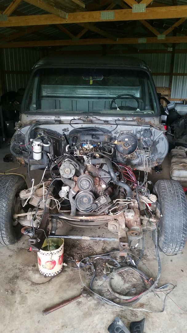

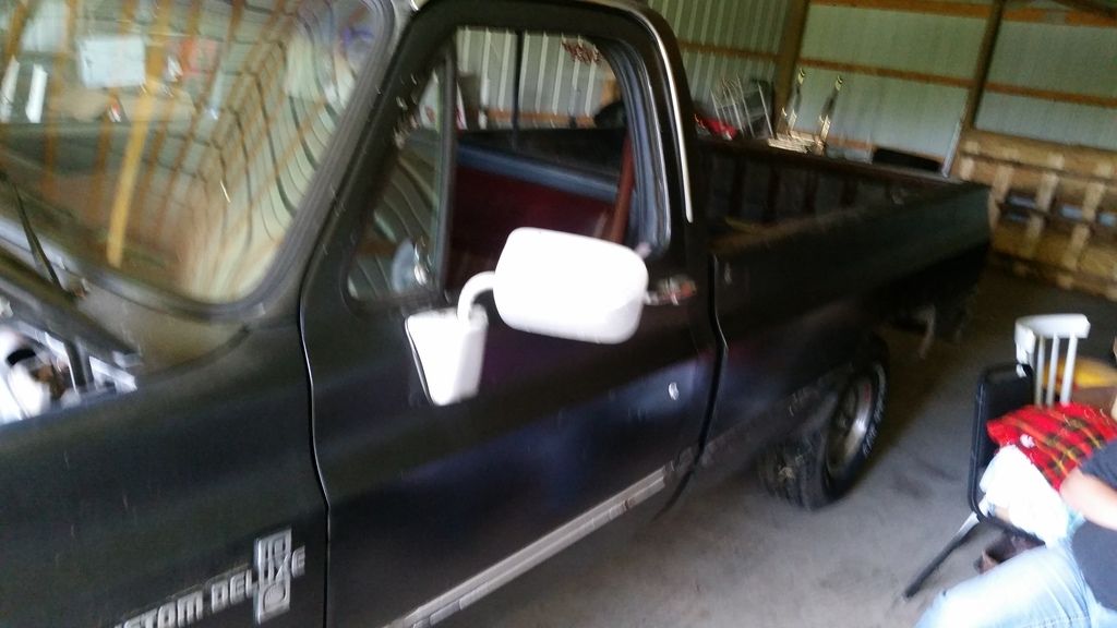

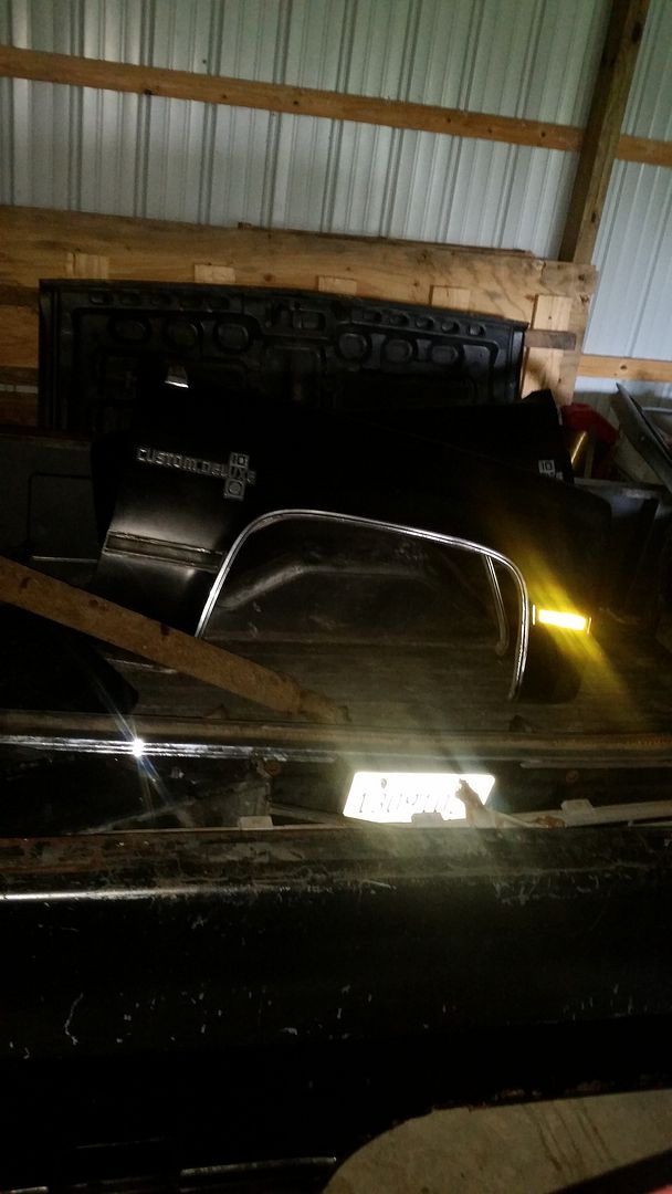

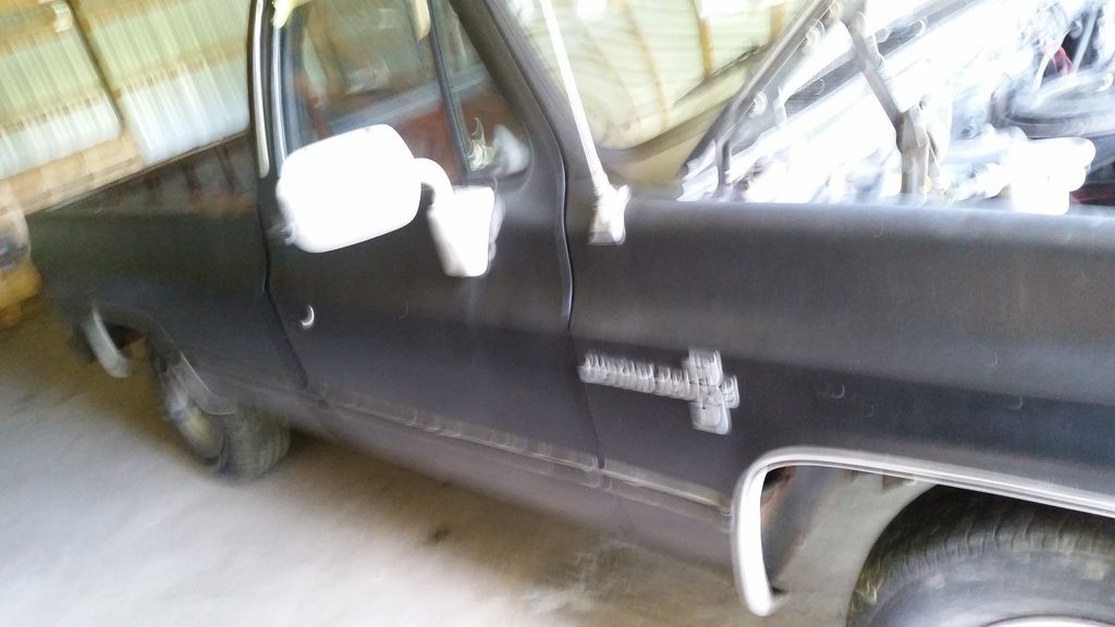

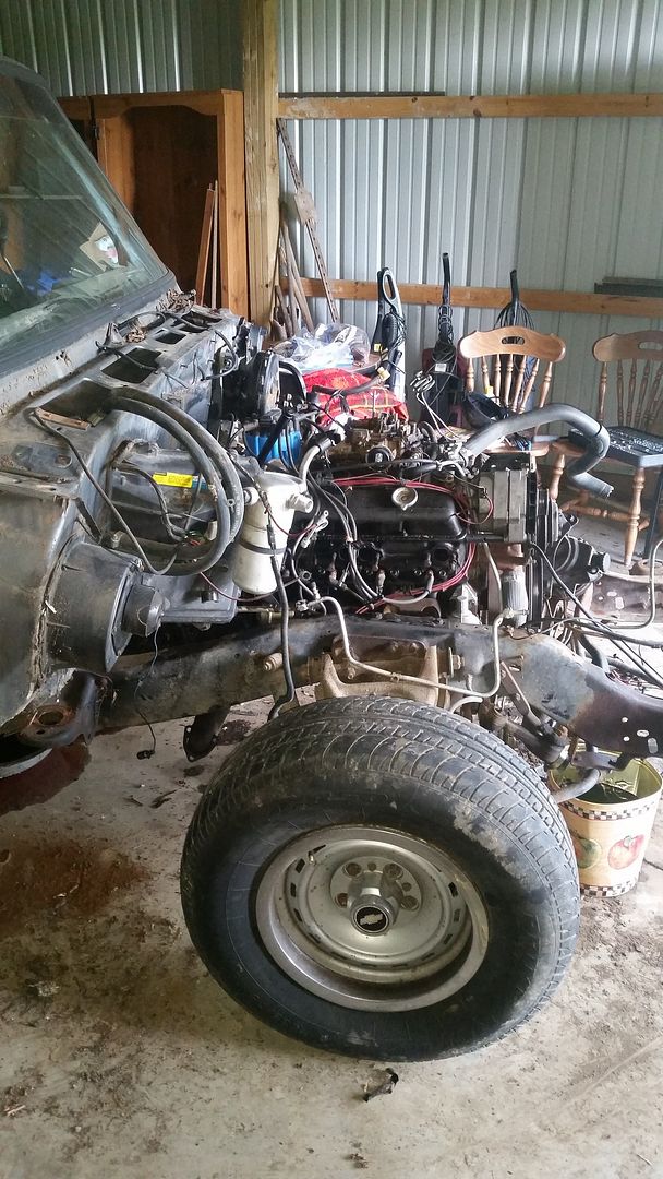

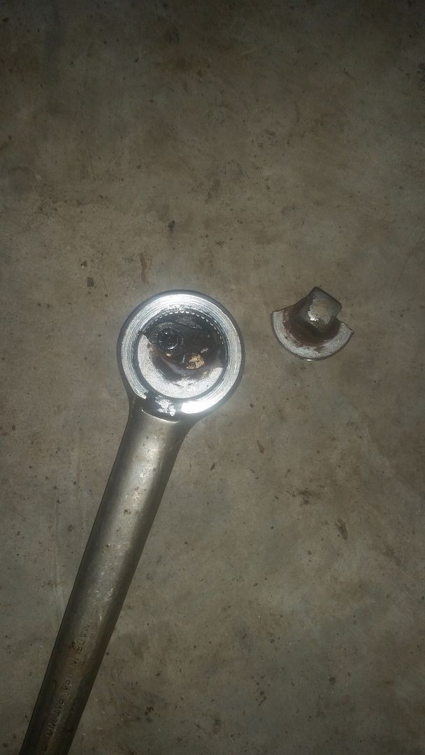

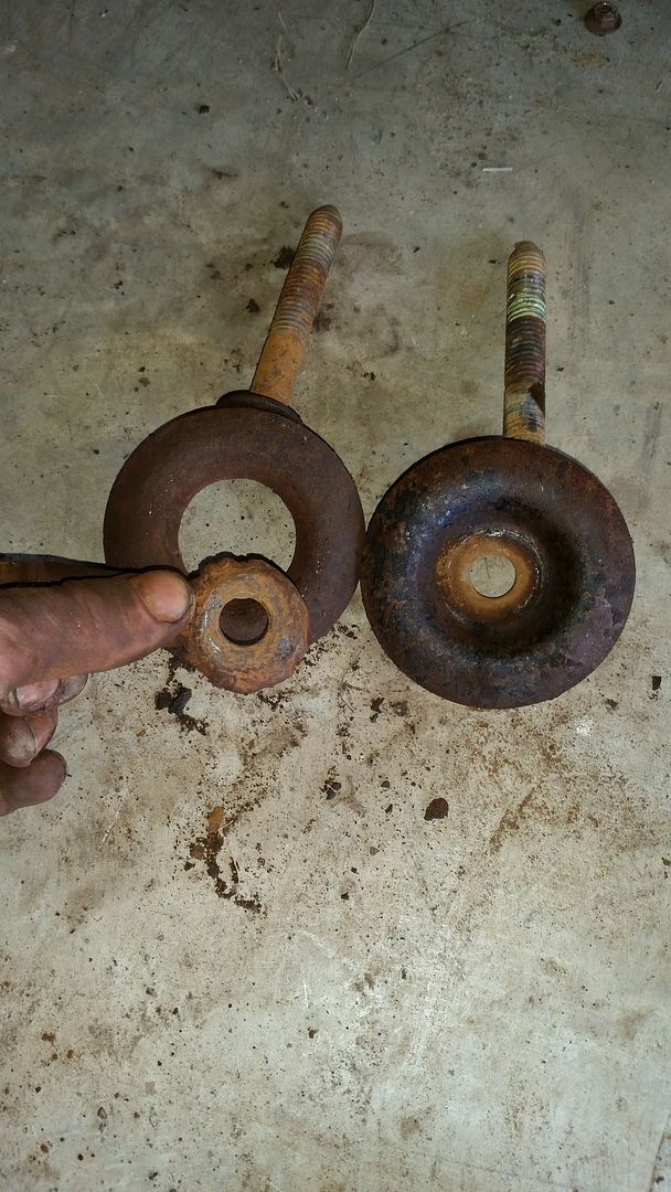

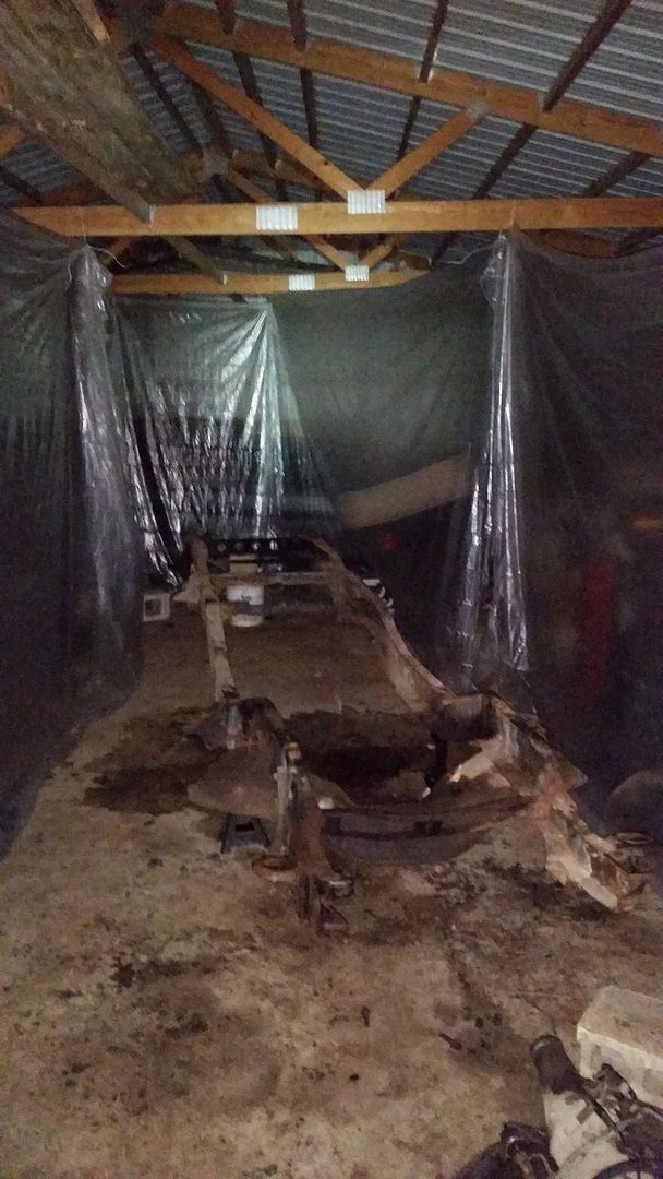

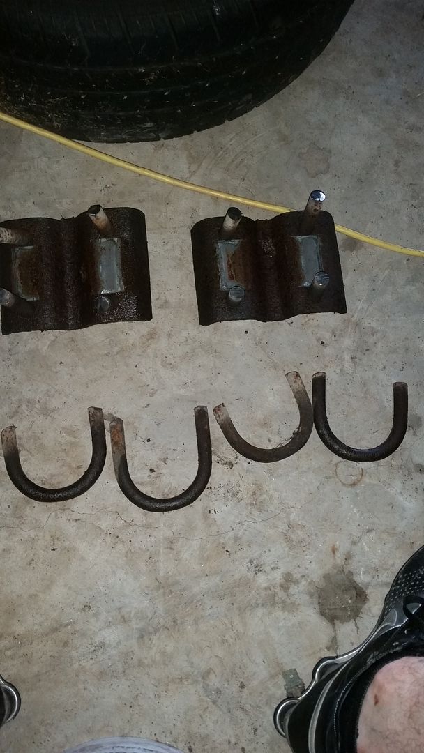

Broken Cups for Cab Mounts

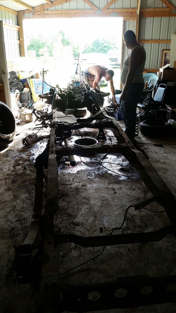

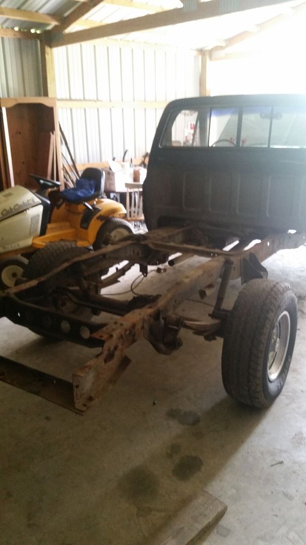

I rocked the cab back and forth on the frame and got it this far while I was waiting on a buddy to arrive.
$70 sk rachet...yea I went and bought a 24" breaker bar after this and some choice words

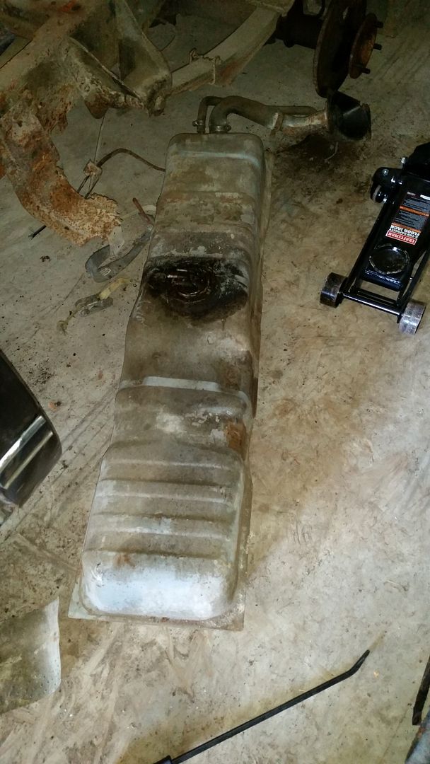

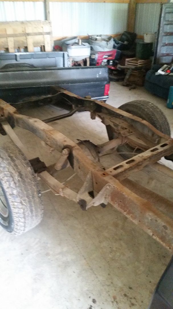

Bed, fenders, front clip, hood, bags of bolts...

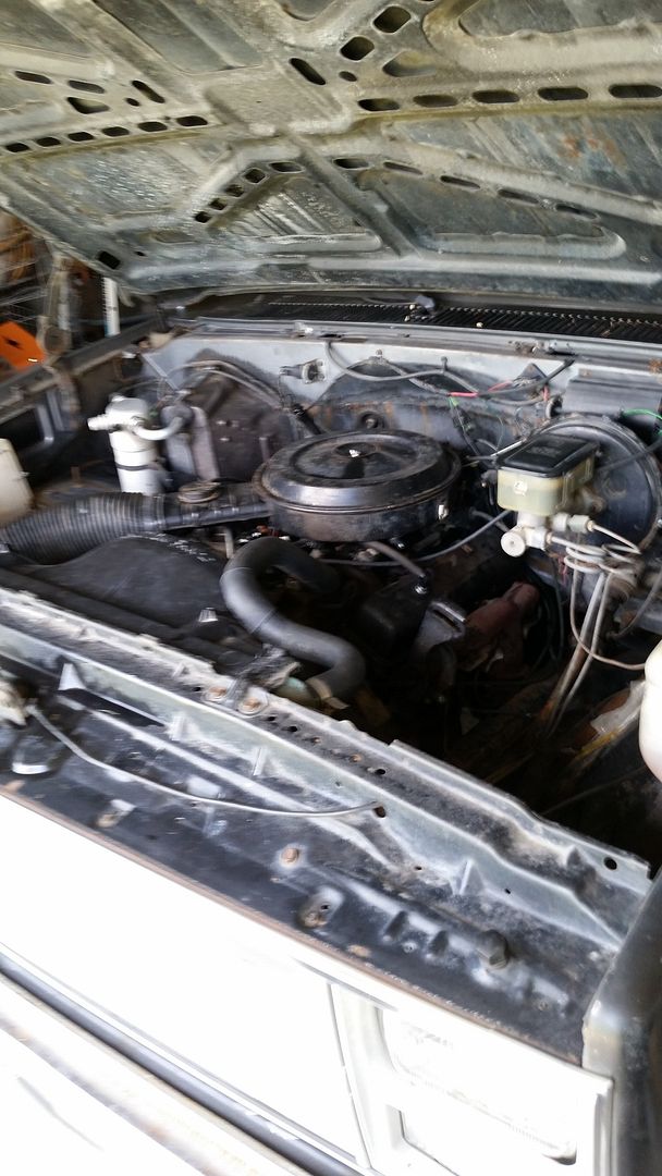

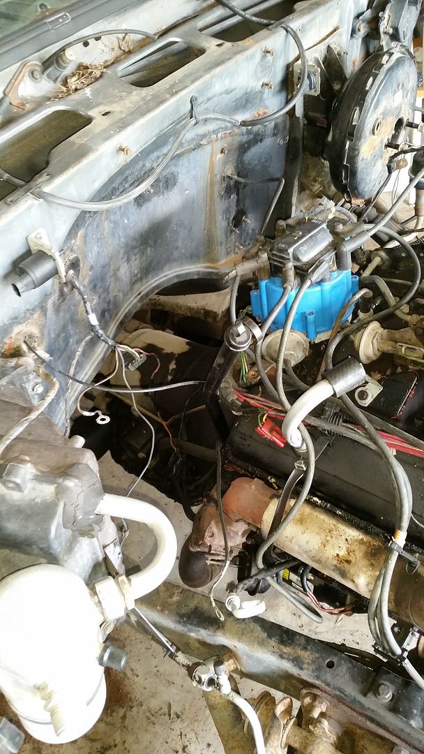

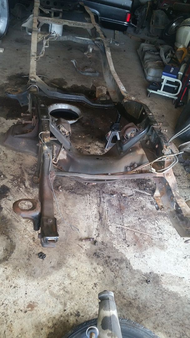

Engine and Transmission off

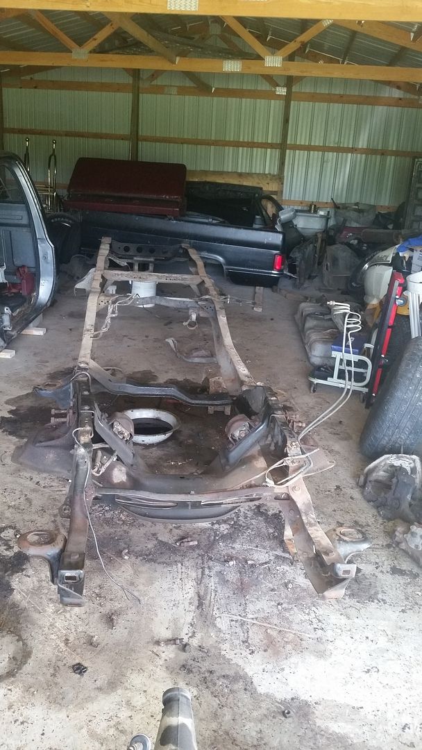

Almost a bare frame

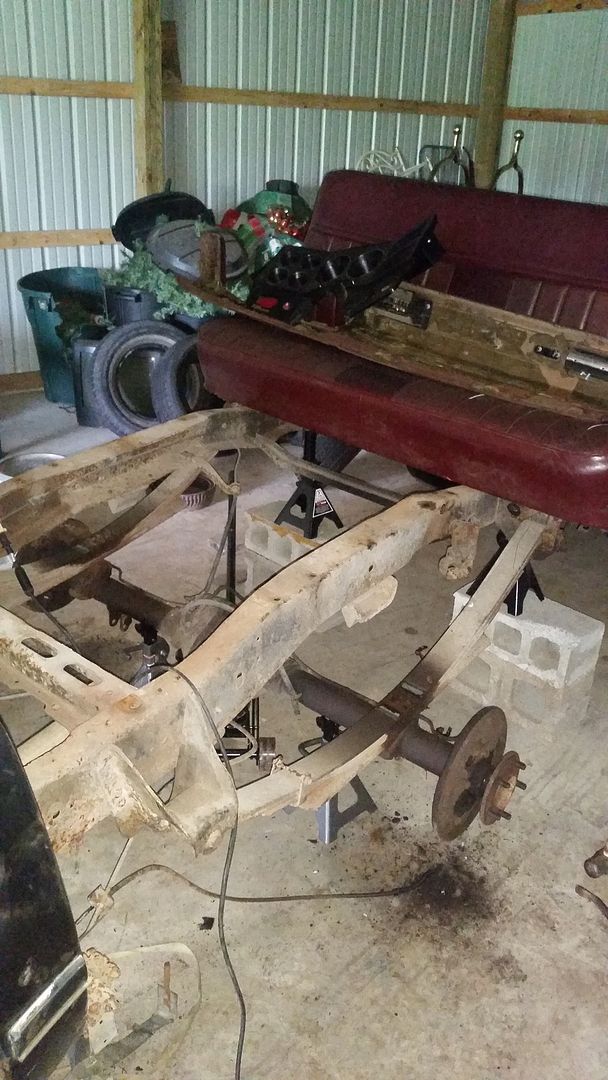

Took a ton of cleaning...19 years of grime, leaks blah blah

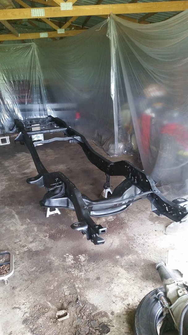

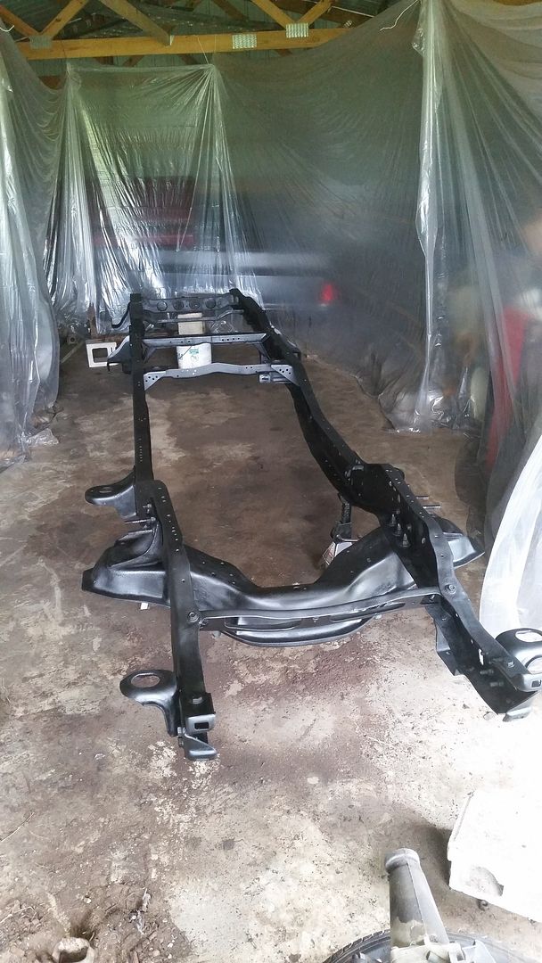

Poor mans paint booth

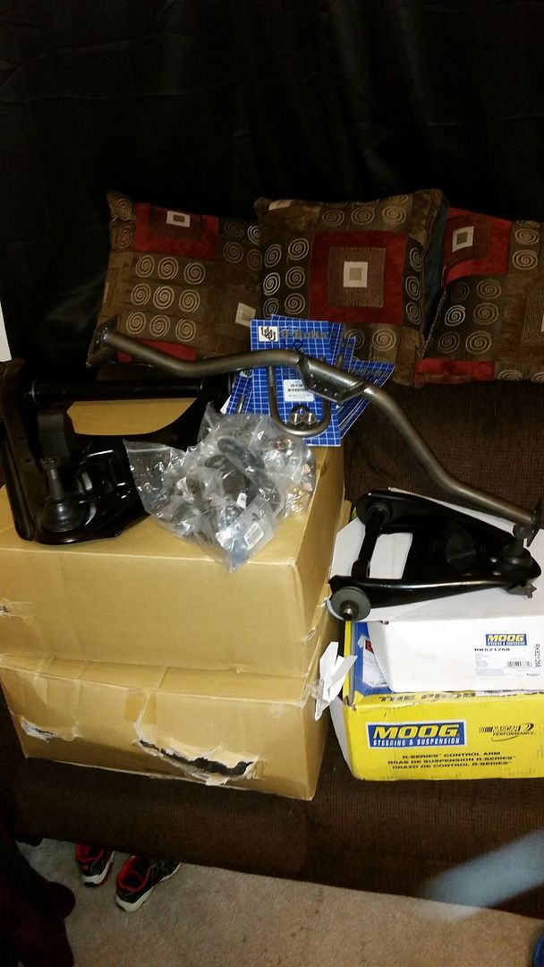

Control arms upper and lower, dual exhaust transmission crossmember from 73-87chevytrucks, all new suspension bolts and hardware.
Going to fedex today and picking up my bushing set and the lowering components should be on their way any day. Ill be painting the leaf springs, rear end, and driveshaft this weekend. Thanks for looking!!
