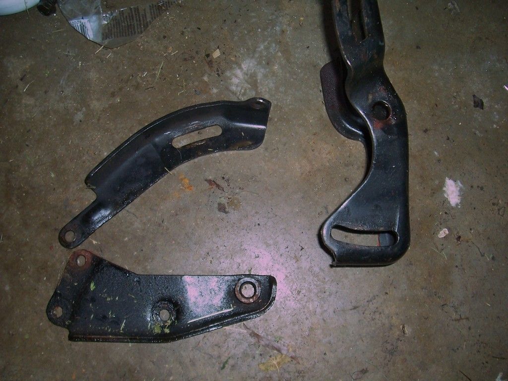

Could you post/walk me thru a step-by-step for re-assembling the power steering brackets?
This is for gen 1 small block---circa 76ish to 87 ish on the lower driver's side.
i have all the parts and actually this is for a 4.3 v-6, but it's the same as an 8 but you already knew that.....
Offline enaberif
  • Posts: 810
Re: Power steering bracket help:
« Reply #1 on: July 04, 2015, 11:15:23 am »
There are two different styles. Take a pic of said parts.

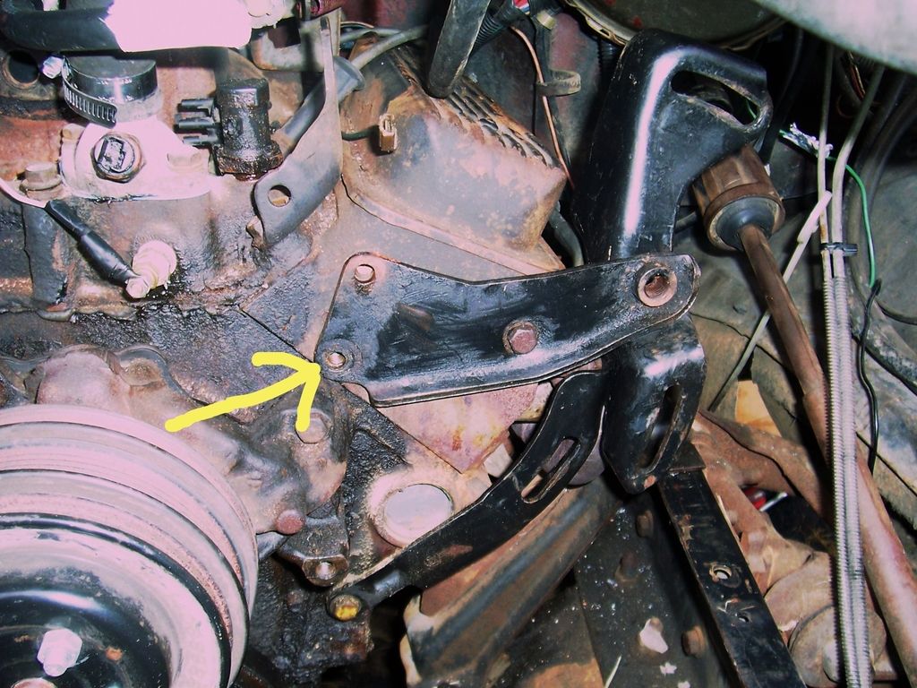

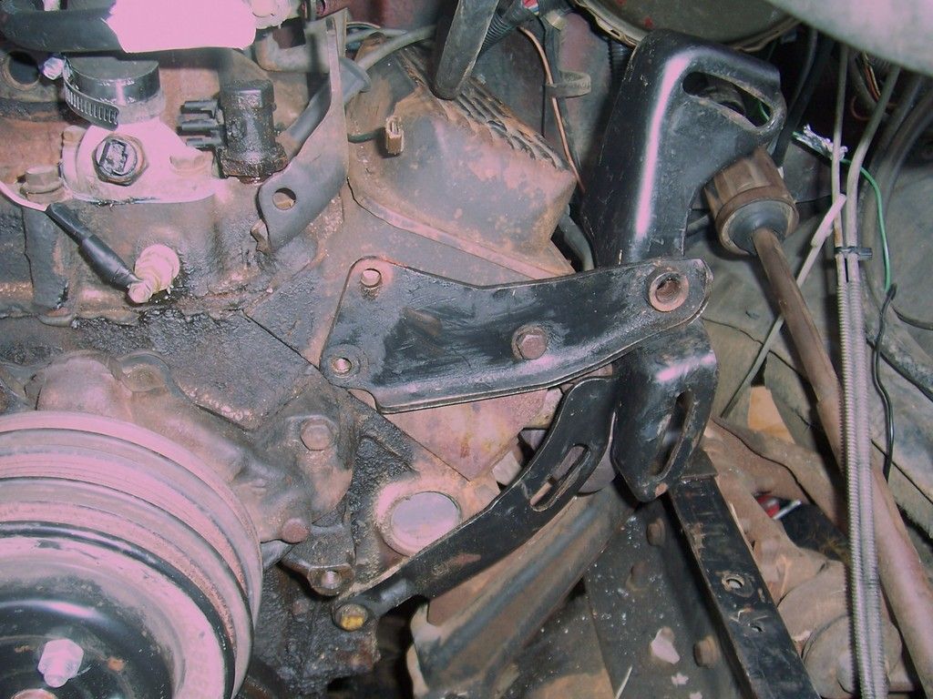

i think this gets me into the ballpark:
i'll save the picture for future reference.
The lower "j" bracket goes on first, followed by the "wishbone" bracket on the exhaust manifold, then the flat bracket bolts to the head.
