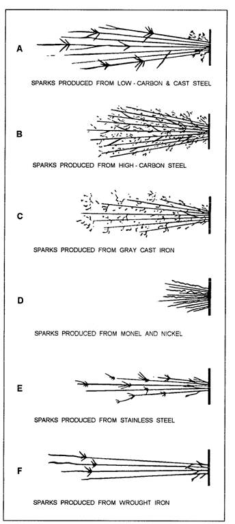

Referring now to figure 1-4, notice that in low­carbon steel (view A), the spark stream is about 70 inches long and the volume is moderately large. In high-carbon steel (view B), the stream is shorter (about 55 inches) and the volume larger. The few sparklers that may occur at any place in low-carbon steel are forked,
Figure 1-3.-Using a grinding wheel dresser.
Figure 1-4.-Spark patterns formed by common metals.

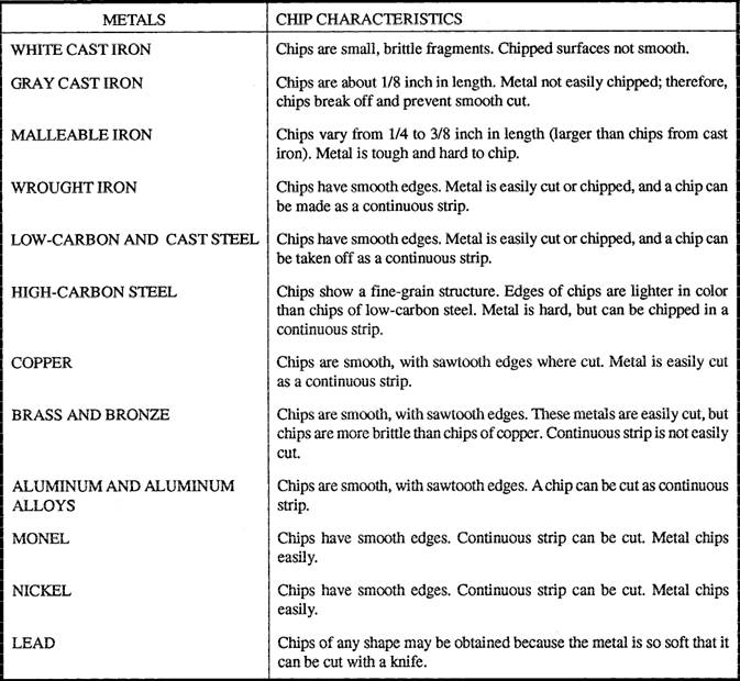

Table 1-4.-Metal Identification by Chip Test
and in high-carbon steel, they are small and repeating. Both metals produce a spark stream white in color.
Gray cast iron (view C) produces a stream of sparks about 25 inches in length. The sparklers are small and repeating, and their volume is rather small. Part of the stream near the wheel is red, and the outer portion is straw-colored.
Monel and nickel (view D) form almost identical spark streams. The sparks are small in volume and orange in color. The sparks form wavy streaks with no sparklers. Because of the similarity of the spark picture, these metals must be distinguished from each other by some other method.
Stainless steel (view E) produces a spark stream about 50 inches in length, moderate volume, and with few sparklers. The sparklers are forked. The stream next to the wheel is straw-colored, and at the end, it is white.
The wrought-iron spark test (view F) produces a spark stream about 65 inches in length. The stream has a large volume with few sparklers. The sparks appear near the end of the stream and are forked. The stream next to the wheel is straw-colored, and the outer end of the stream is a brighter red.

Another simple test used to identify an unknown piece of metal is the chip test. The chip testis made by removing a small amount of material from the test piece with a sharp, cold chisel. The material removed varies from small, broken fragments to a continuous strip. The chip may have smooth, sharp edges; it maybe coarse­grained or fine-grained; or it may have sawlike edges. The size of the chip is important in identifying the metal. The ease with which the chipping can be accomplished should also be considered. The information given in table 1-4 can help you identify various metals by the chip test.
