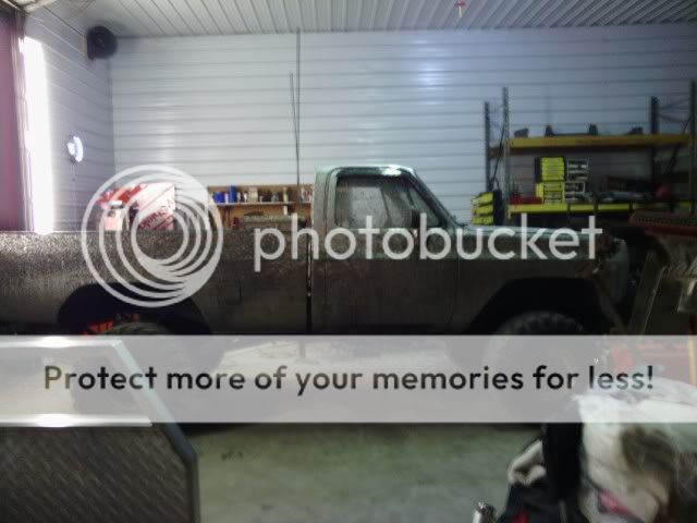

body lift it now then once youre ready put a suspension lift in
my mud trick with trimmed fenders and 6"+3" lift
with 38s
think 40s
and 44s
Re: Trimming for 36's

I wouldn't say the truck is extremely rusty, but it's dented up and has definitely seen better days. The front of the iner fenders has completely rusted out, there's rust holes in the doors and cab, and the bed had completely rusted out so the PO replaced it with a later 80's bed. Who knows how much more rust is hiding under the rattle can paint. No one would buy this truck for its fenders or looks. Once I get my Toyota back on the road I will likely just turn this into a street-legal mud truck.
Irish_Alley, I really like the look of your cut fenders. The way they seem to simply expand the wheel wells they look almost like they could have come that way stock. How much did you chop off those? Also, what did you mean by saving my money and not lifting the truck?
« Reply #12 on: August 27, 2015, 07:26:40 pm »
i didnt cut them so i cant answer you on how many inches. and i think someone done them professionally cause they are rolled over so it does look bad. but imo it doesnt look right till i put 40+ inches on it. but what i was saying is you could just initially cut the fenders and not worry about buying a lift kit and just keep the cut fenders.
