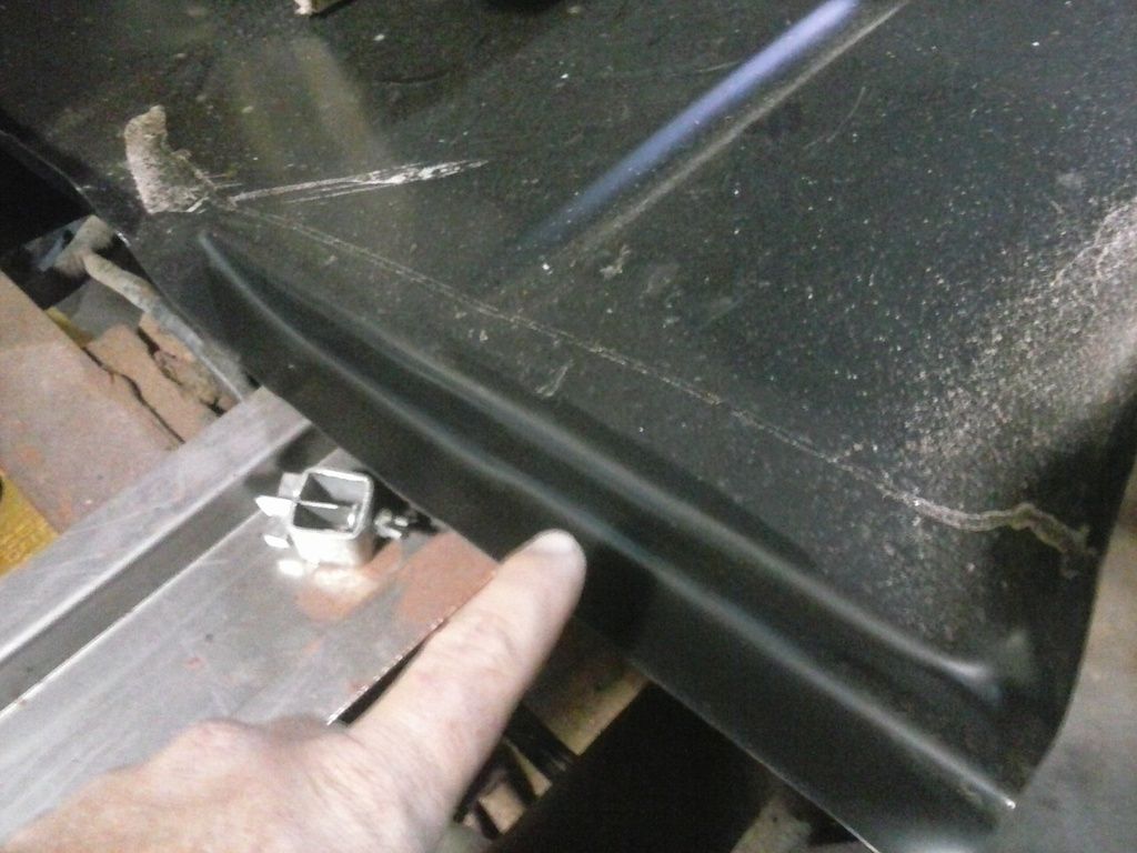

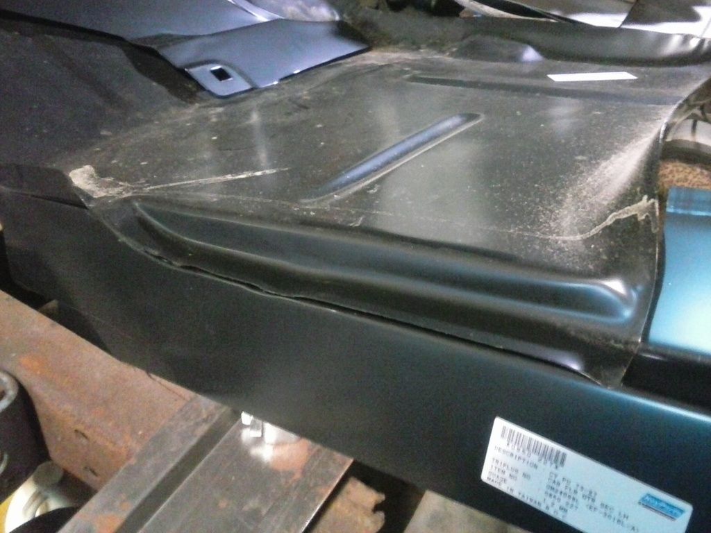

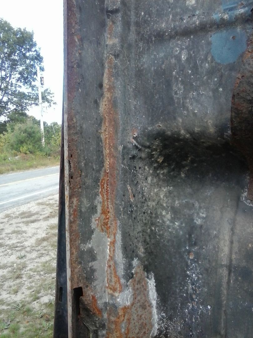

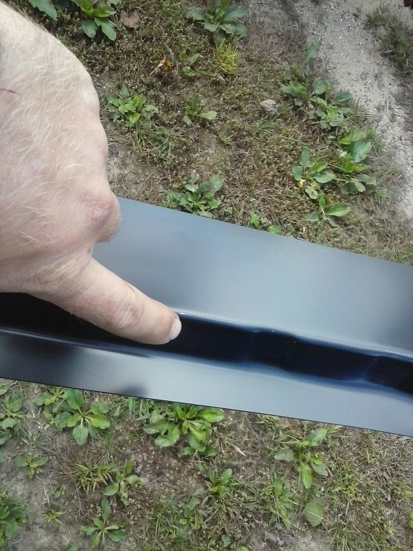

sorry for late reply, but here are some pics
a partial inner rocker tends to go more into the floor then the outer floor pan/inner rocker patch
but here we have a full floor, and full outer floor/inner rocker(not to be confused with partial inner rockers, that are commonly just called inner rockers)
I am pointing to the lip that should be the same if it was manufactured as a single piece, not two pieces
here I lied them atop each other so you can see how they are supposed to mate
and the under side of an unmolested passenger floor/inner rocker
if you would like me too, I can try to get better pictures, otherwise you can look into my thread I should(hopefully) be doing pictures that will document it well

Re: Inner rocker confusion.
« Reply #5 on: September 21, 2015, 06:10:23 am »
KaiserM715
Where he is pointing the outer rocker sits on top of that section.
I would not recommend making that section three layers thick though. Need to trim off that strip from I would say the inner rocker, not the floor section.
