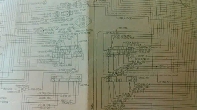

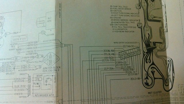

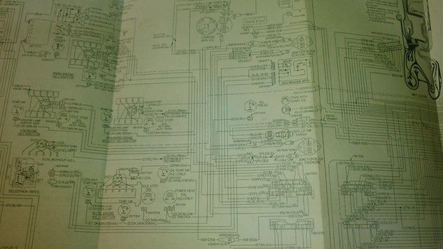

« Reply #6 on: December 25, 2015, 02:42:01 pm »
OK found the wiring diagram for the 75, should be close enough.
This would be the wires through the bulkhead connector...
This part is for the circuit board connections...
And this is an overall...
They might not be much help unless you can get it to expand clearly. If you can figure out where I might take a close-up I'll be happy to.

« Reply #7 on: December 25, 2015, 09:40:22 pm »
The connector in question near the booster is a tan wire under the gunk. Wire # 20T141B     Ties into the TCS/Radio fuse.
TCS.  Trans controlled spark (optional)
That's According to my 74 wire manual
Offline Greybeard
  • Posts: 462
Re: I need help with to problems
« Reply #8 on: December 25, 2015, 11:36:37 pm »
On the pages of the 75 wire diagram that wire color and number is for different engines available that year but regardless it was used for the idle stop solenoid. Not used with an automatic trans.
So, it's always good to have choices  ;D
« Last Edit: December 26, 2015, 06:03:36 pm by Greybeard »
Offline blazer74
  • Posts: 786
« Reply #9 on: December 26, 2015, 10:42:48 am »
Yep the idle stop power comes from the same place if used. Wire 141 has diff variables.
