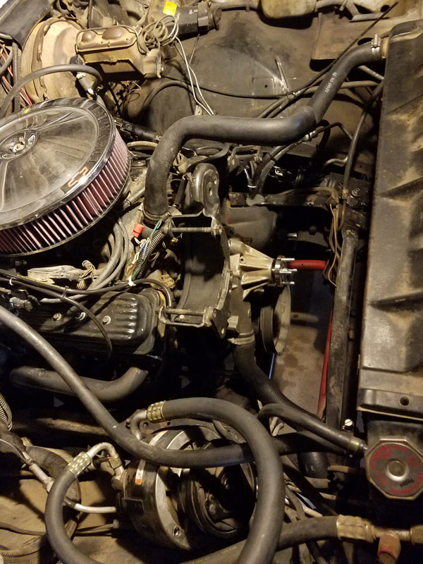

Step 1: Park your truck in a comfortable place

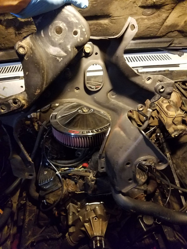

Step 2: Remove everything attached to the drive belt, except the water pump. Here you can see I was able to leave the radiator hoses in place, and simply maneuvered the a/c compressor out of the way with the a/c hoses still attached. I did the same with the power steering pump -- still attached, just out of the way a little. I guess the only things to actually come out were the fan, the alternator and the tensioner.
Here I am pulling out the bracket that holds them all in place.

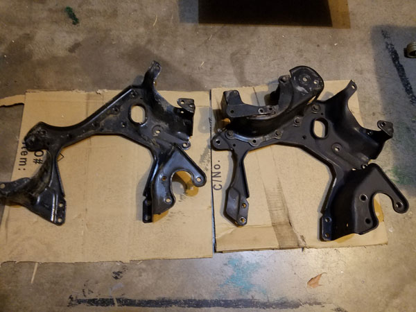

I got the one on the left off of ebay. Notice the section on the far left that holds the air pump.

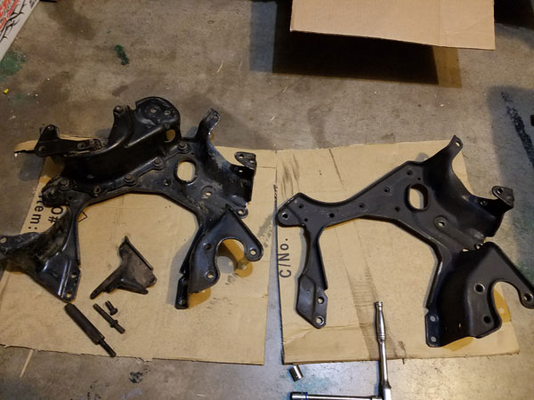

And here's the new one with the a/c bracket moved over. I also have a few other things to attach to it. I have no idea how these are supposed to fit to this thing with the air pump attached. It's going to be a fun puzzle. :-)
