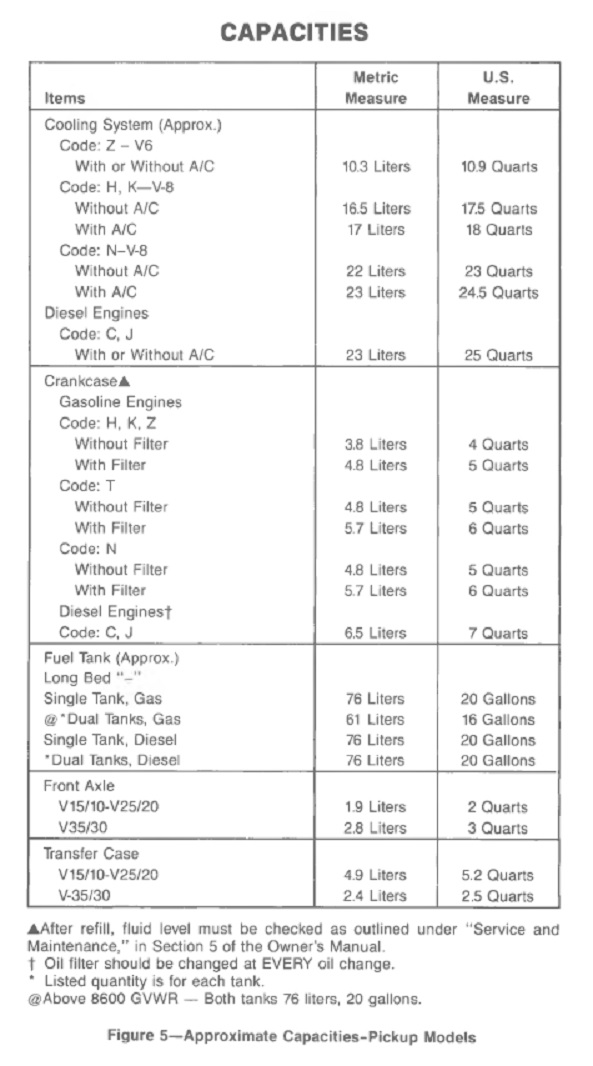

I was wondering if anyone knows how much coolant the system will hold?

Refer to the capacities listed for engine code H in the following chart:

Thanks bd
