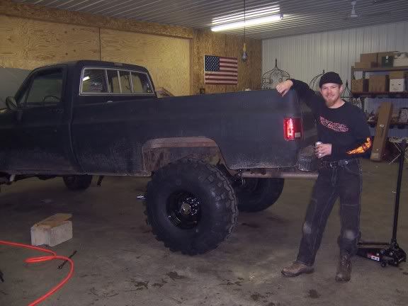

I would recommend going with a smaller lift than 8". I would say 6" max, especially if you are going to be using this truck as a DD. The truck I am building right now is a 76 Chev.I put a 82 body on it and  4" of lift in it before and was running 35" BFG M/T tires. I had to do a slight amount of fender trimming to clear the tires at full stuff. I had the Dana 44 front, 12bolt rear axles with 4.10 gears. You do not want to go with any higher(lower number) gears than this, IMHO. Here is a pic of my truck as it sat with the 4" lift.
Now I am installing a 8" lift, swapping my 1/2 ton axles for 1 ton CUCV axles and running 39.5 Super Swamper TSL's. I will need to do more fender trimming to make these tires fit, but it is not a huge amount. One thing to remember is the higher you lift it the more its going to cost you. 8" of lift for your truck will require longer brake lines and also lengthening your driveshafts. I did not have to lengthen my shafts because I went to the bigger axles. You would also need the drop pitman arm and raised steering arm. Here is a pic with the rear lift in. I am 6'1 and the top of the box comes up to my eyebrows:lol

I love your step to get up in that skyscraper. Cinderblock and wood....do you take that with you everywhere???  How about a parachute to get out?

:lol   Thats what I had to set the jackstands on to swap in the 14FF rear end. The parachute stows neatly behind the seat though:lol
