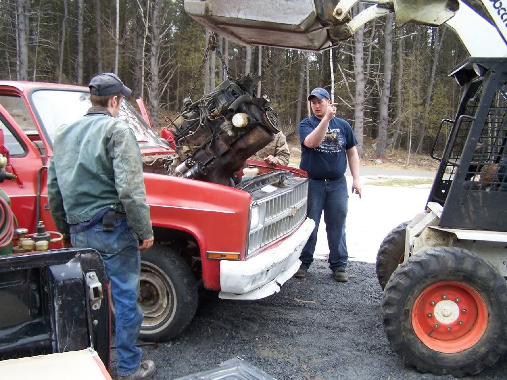

Hey All, The pics (they better work...) are of my 81 C10 that I got from an old farmer...It was never driven on the road, just had farm plates, But, in 2002 he blew the I6 250 that was in it, because he was deaf and couldnt hear. So I got it from his son when I was home on leave for Christmas.

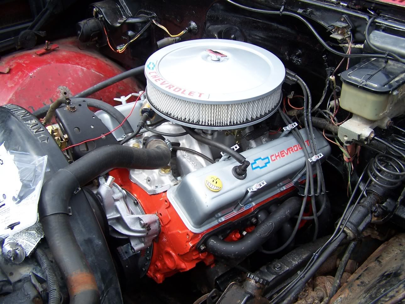

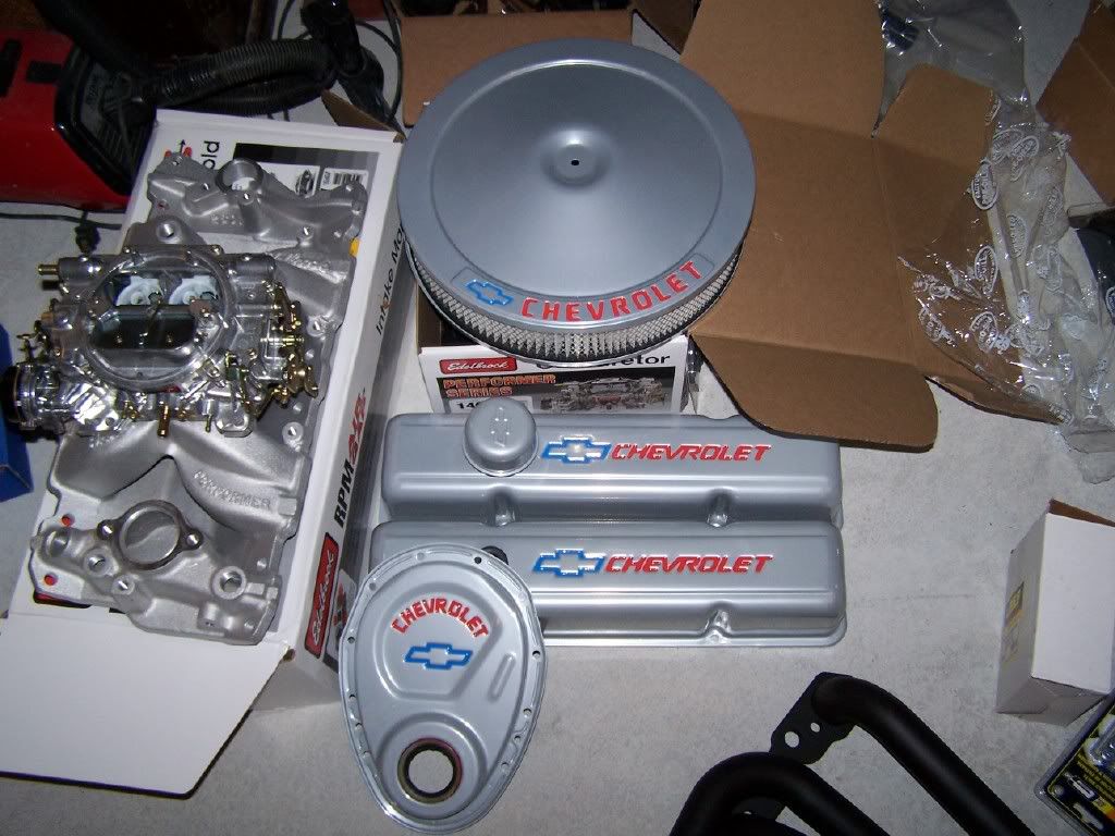

When I came home again for a few weeks, I had a brandnew GM Crate 350, a rebuilt SM465, Edelbrock 600CFM carb, Edelbrock Intake, and Hooker SuperComp headers. I had to work day and night with my Dad and Brother (also Military), but we managed to get it running (yar!)..But without the exhaust lol. (Exhaust is Flowmaster Super 40s (x2)).

On the last pic, on the old motor..you can see where the connecting rod blew apart, and dented the oil pan like a BB gun hit lol :rolleyes
