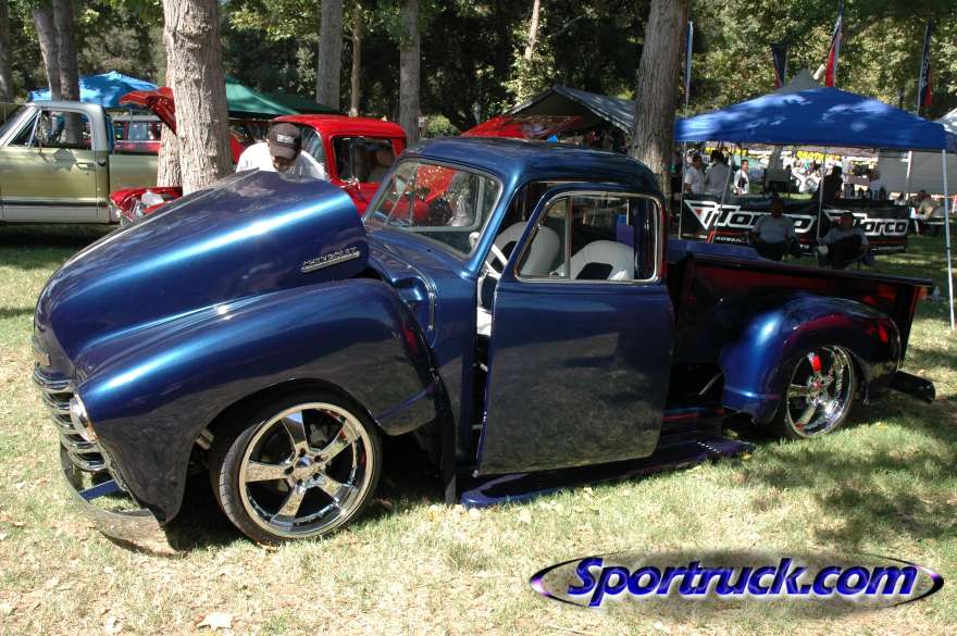

Would it be possible to do a one piece front clip hood like the one below?  What would be involved in doing such a project?  I haven't looked recently, but do the inner fenders support anything?  I know there's stuff like the battery tray and A/C (which I don't have but want to get), but would these matter if I wanted the fenders to go up with the hood?

Do you want fiberglass or steel?  Steel is going to require A LOT of welding and it is going to be HEAVY when you lift it up.  Inner fenders don't add a lot of structure, but they do ad bracing from the fenders to the core support.  Many people leave them out, but if  you are building a show truck and plan to drive it and have nice paint on it, the firewall is probably going to be hammered with rocks.
Chuck did this to one of his trucks:
http://www.chuckschevytruckpages.com/tilt1.html

Well if it meant that I couldn't keep the inner fenders then I don't think I'd try it.

There is no reason you have to leave the inners out of it.
What Pat posted is what I am using here: http://forum.73-87chevytrucks.com/smforum/index.php?topic=5225.0
