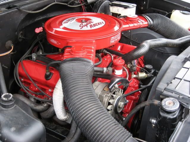

You could always find another stock air cleaner, cut its snorkel off, and graft it onto your air cleaner.  Then you improve breathing on the top end and get cold air.  Here's an excellent example on HAULIN IT's rocket-powered '86.

1) First off i recommend the stock air cleaner if it's a daily driver for efficiency.
a) what is "bug eyes?"
b) if you want it to breath more, you might try flipping the air cleaner lid (if you are using the stock one) over.
2) i noticed in the picture that not only are there vacuum lines running to the snorkles on the air cleaner assembly, there is a heat tube connected to the exhaust manifold going into the snorkle(s?).  Is this correct?

Stewart, Yes, When I first made the air cleaner (in 1998, I think) the truck was used year round. Think winter... 455,posi, sand bags & snow tires! Anyway, I took a piece of 2" square tubing about 4" long & capped the ends with tabs going outward to mount the "box" to the front Two header bolts, then cut the bottom out to match the header tube & drilled a hole in the top, welded in a piece of exhaust tubing for the hose (this created a heat plenum so to speak). The Left snorkel had the hole welded shut on the bottom. It worked pretty well. Now before you ask if I'm running heated air to it while I'm racing... No! All of that is not functioning any longer. A couple years ago I tapped a freeze plug in the bottom of the "hot airbox" (the last time I had it off, I left it off) & cut the flappers, ect. out of the snorkles. Lorne
