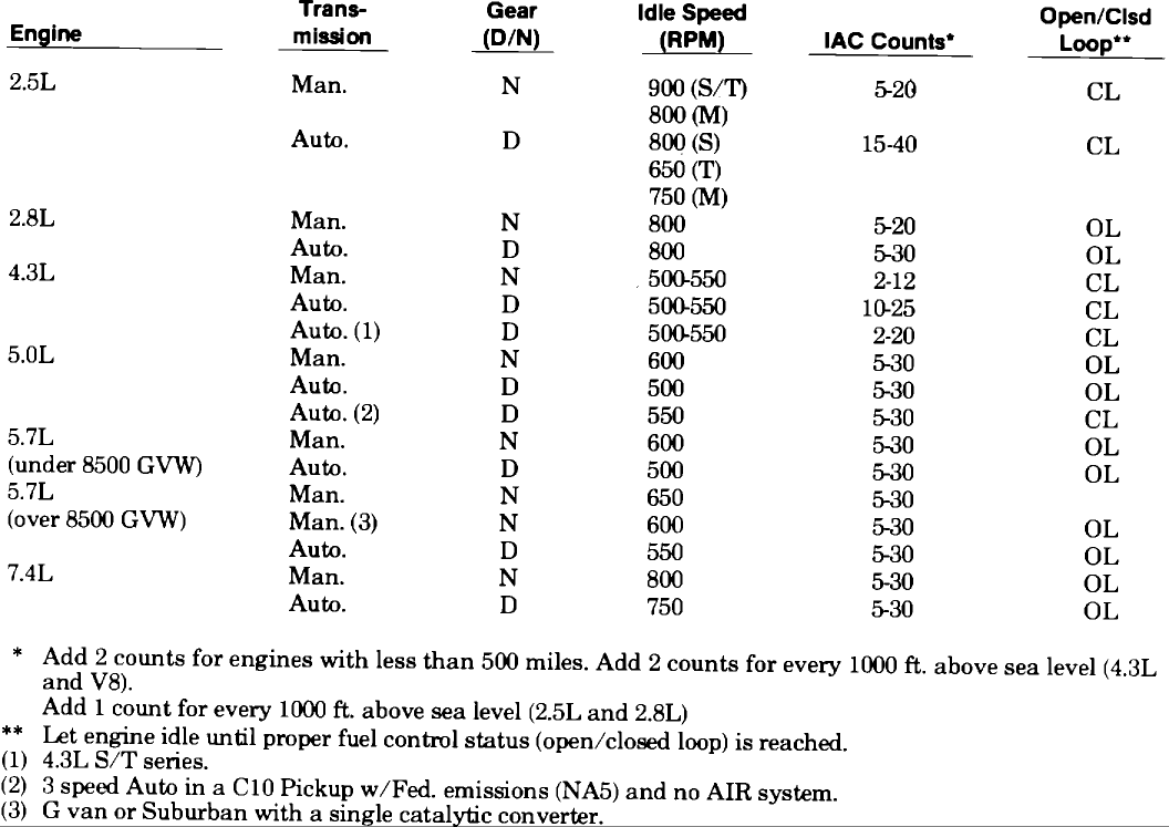

GMC NUMBER: 88-T-55
GROUP: 6E - Engine Emissions
DATE: November, 1987

Controlled Idle Speed Check
Before performing this check there should be no codes displayed, idle air control system has been checked and ignition timing correct. The procedures to check the idle air control system can be found in the Light Duty Truck Fuel and Emissions service manual at the following locations:
All Truck Engines Except 2.5L       Page 4-11
2.5L Truck Engines                  Page 3-61
1. Set parking brake and block drive wheels.
2. Connect a "SCAN" tool to the Assembly Line Data Link (ALDL) connector with tool in Open Mode.
3. Start engine and bring it to normal operating temperature.
4. Check for correct state of Park/Neutral switch on "Scan" tool.

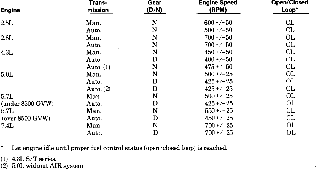

5. Check specifications chart at the end of this bulletin for controlled idle speed and IAC valve pintle position (counts).
6. If within specifications, the idle speed is being correctly controlled by the Electronic Control Module (ECM).
7. If not within specifications, refer to "Rough, Unstable or Incorrect Idle, Stalling" in Section "2" of the Fuel and Driveability Manual X-8736 and review information at the beginning of this check.

NOTICE: ON 2.5L ENGINES A SERVICE ENGINE SOON LIGHT WILL COME ON AND A CODE 35 WILL BE SET.
10. Check rpm against specifications at the end of this bulletin. Disregard IAC counts on "Scan tool with the IAC disconnected. If the engine has less than 500 miles or is checked at altitudes above 1500 feet, the idle rpm with a seated IAC valve should be lower than values in chart.
11. If the minimum idle air rate is within specifications, no further check is required.
12. If the minimum idle air rate is not within specifications, perform the following procedures:
13. If present, remove stop screw plug by piercing it with an awl, then applying leverage. The screw is covered to discourage unauthorized adjustments.
14. With engine at normal operating temperature (85-100 degrees C), adjust stop screw to obtain nominal rpm per specifications with seated IAC valve.
